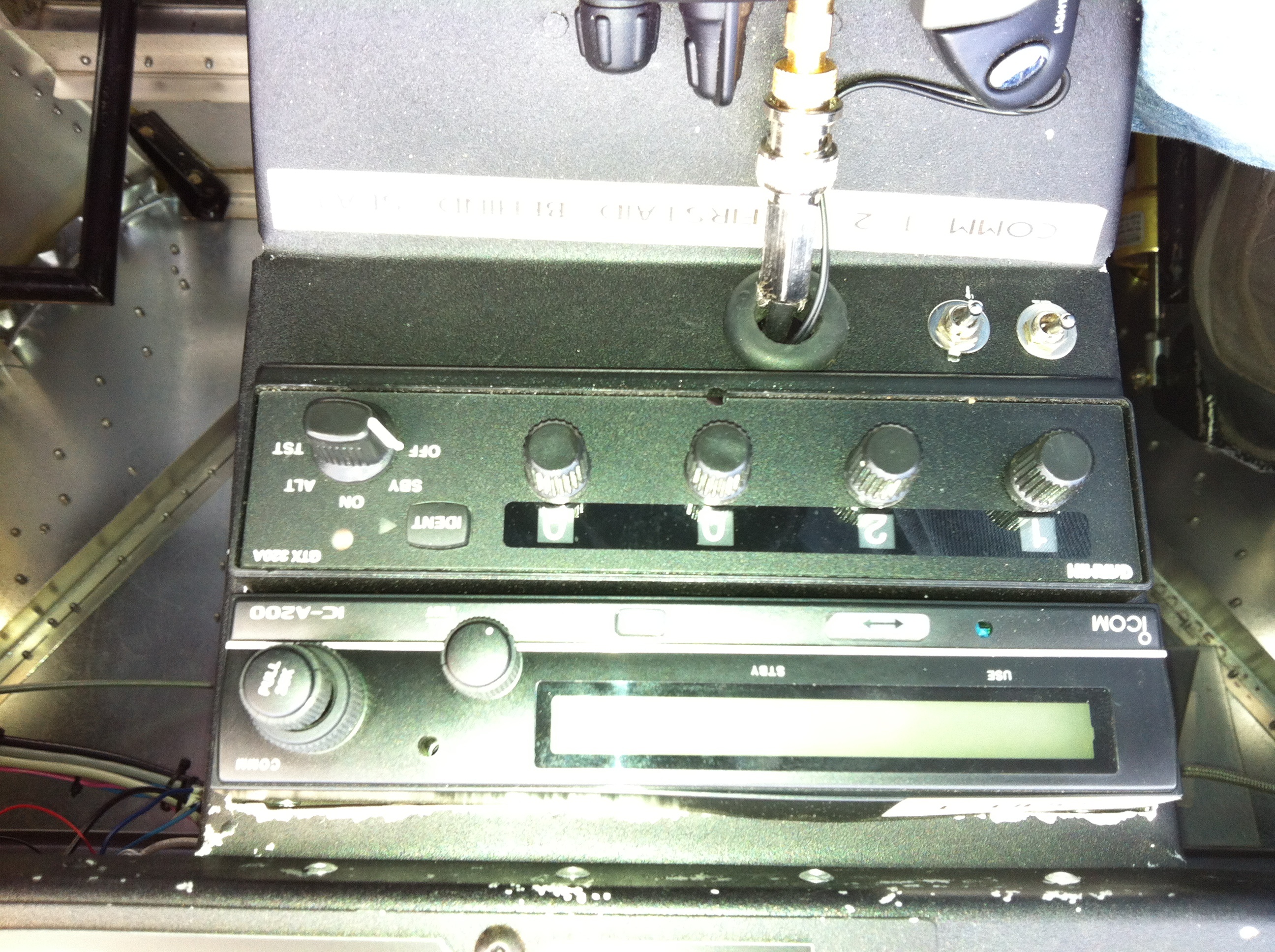

Hello all. Just purchased a Homebuilt Zodiac 601XL-B. Rotax 912ULS powered. A200 Radio, Flightcom 403 intercom. Aero flash strobes. The radio is intermittently squealing and tower cannot understand my transmissions. Tried both engine running and not running. Intermittent either way. When it is working, I get 5/5. When it begins squealing, 0/0. Previous owner said he had the same issue with cheaper headsets. Radio worked great, then it didn't. I'm using David Clark 13.2s's. The previous owner has a portable wired in as well, telling me that he's had issues in the past. There is a falcon T/B gyro, Garmin transponder and aero flash strobes. When the strobes are on, the pop of the flash comes thru headsets. I'm really stuck! Bought this plane, and now can't fly it! The rest of the plane is great,, ending runs PERFECT..... But this radio issue has me beat! HELLLP!
Chad. Sad
Additional info..... There is a handheld wired into the system. It uses its own separate antenna, but there are two switches on centre console to flip send receive. I wonder if that wiring is causing the problems.
Helllllp!
