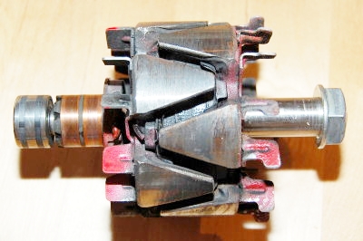

An automotive alternator is already crafted as a 3-phase
device. The configuration requires that pole-pairs on the
rotating magnet come in some multiple of 3 (usually
6 pairs but can be more on larger machines).
[img]cid:7.1.0.9.0.20121031151100.01e2d220(at)aeroelectric.com.0[/img]

The BIG toe-stubber is pole piece configuration. The magnets
glued to the inside of the popular PM alternator shells (or
wound-field machines) are already optimized for their as-
manufactured condition. It takes more than a 'rewinding'
to morph from single to 3-phase configuration. But assuming
all other things are held the same, the watts-per-pound-per-
velocity will be the same for both configurations.
