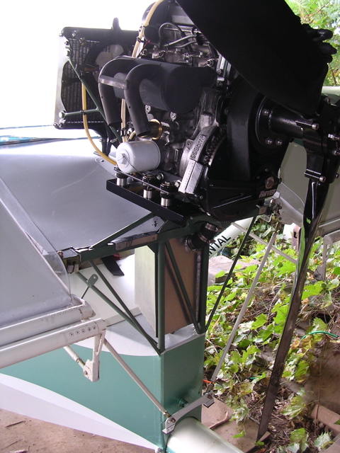

Looks like a mkIIIx with a nose job. Good looking airplane. Does it
have a modified gap seal between the wings? I don't remember seeing
it when Nell and I came by your place several years ago.
John, you looked at it but was suffering from a caffeine deprivation.
Since my windshield has been dropped a few inches the gap seal is
a continuation of el cheapo hardware store aluminum at the same level
as the windshield.
If you look close you can see the lexan root fences that keep the air
on the wing. Having flown it without them I can say they made a BIG
difference.
The nose is sheet metal with a foam plug, which I have reshaped TWICE
now and
still not entirely satisfied. Oh well, that's the way with cosmetic
surgery....
