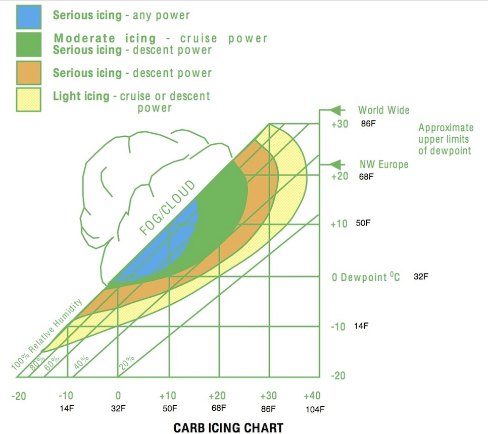

PostPosted: Fri Oct 26, 2012 4:19 am    Post subject: Re: 'Tis the Season' Reminder Reply with quote
Gary,
Unless your Jab2200 is a very very early one, the Bing carb on it is a 94 (40mm). They used a 64 model (36mm) for only a short while and it didn't take them very long to determine it was not big enough. However, they are of similar design and function much the same way,
I've not had any carb icing in my Slingshot with Jab2200 but in the 11 years I've been flying Rotax 912 engines, I've had two carb ice incidents. Detecting it early both times, I was able to get rid of it by cycling the throttle idle to WOT, back and forth a couple times. In both cases it was in warm weather with high humidity.
