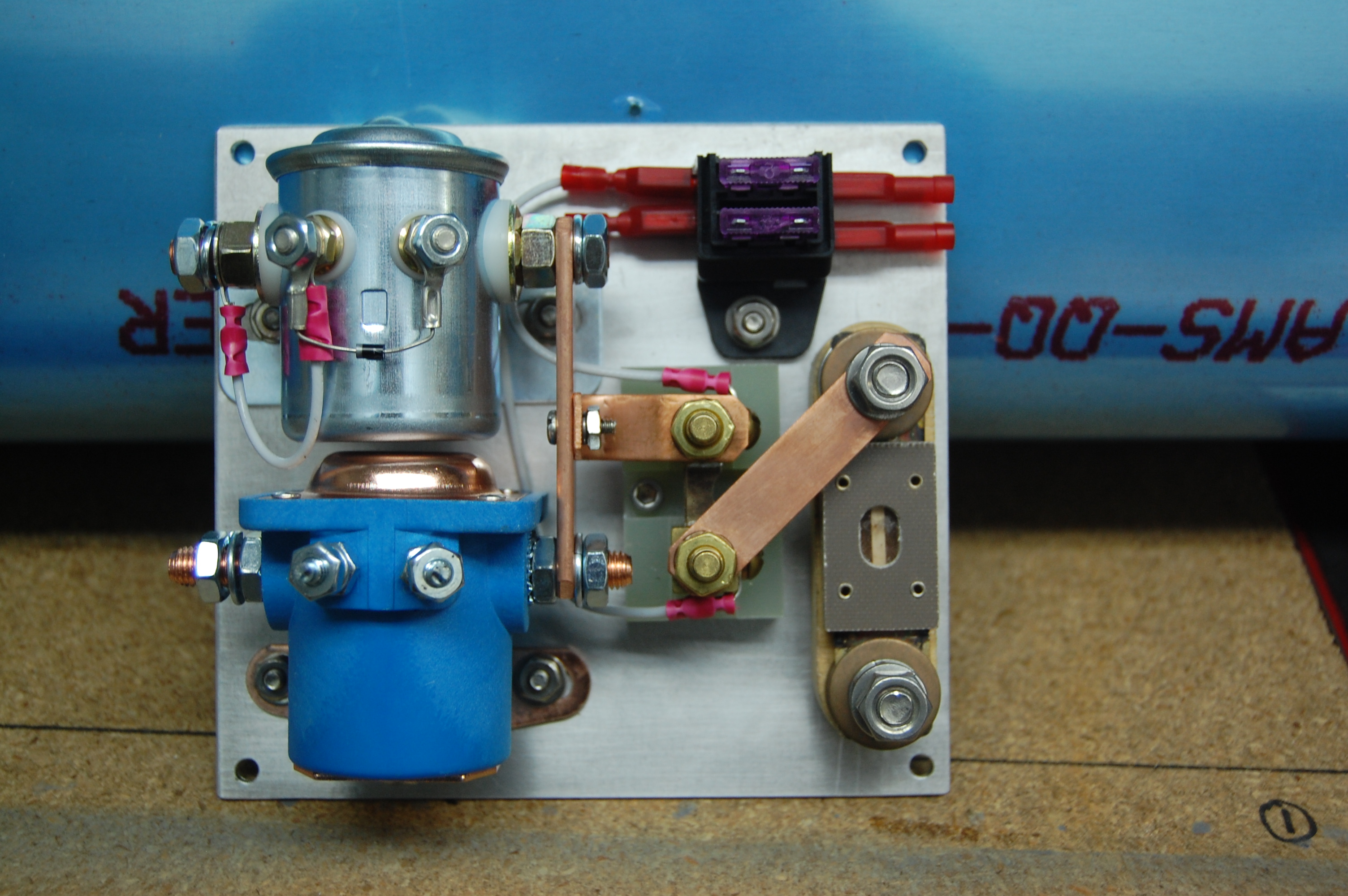

Shunt rating is not directly related to alternator output. It is directly related to how the ammeter is calibrated. Therefore you must match the shunt w/ the ammeter. Also, there is nothing magic about manufacturer/ammeter/shunt compatibility. A shunt is essentially a highly-calibrated resistor. So a shunt from manufacturer A will work just fine w/ an ammeter from B as long as their “mili-volt” rating is the same. The ammeter will tell you, for example, that it requires a 50 amp, 50mV shunt. (You want to have an ammeter/shunt current-rating that exceeds the alternator output).
Ed, in your case you need to decide what range ammeter works for your application. I might recommend a 50 amp ammeter, or maybe a 60 amp is a little more common. Then buy the appropriately-rated shunt for that ammeter (from any manufacturer) and you will be good-to-go. You may never get full deflection on the positive/charge side of the ammeter (because the alternator only puts out 40 of the 60 amp the gauge can display) but that’s not a big deal. (BTW – I always recommend a zero-center ammeter because it can show a lot of useful info, however, the shunt must be placed in the correct location in the battery circuit. But that discussion is beyond the scope of this message)
I recently shopped for ammeter hardware and I decided on a 60A VDO ammeter (they are a little pricey, but I like the way they look and the 270 degree needle sweep is really cool!). Then I bought a shunt from whoever had a good price. I think I got the shunt from AC Spruce and was about $35 (the VDO shunt was over $70 and was gigantic) – It all works just fine.
You might look at ACSpruce as they have several ammeters & shunts available.
In the attached photo, the shunt is the thing just right of center and has a light-green base. Don’t forget to fuse BOTH wires that go from the shunt to the ammeter. They are both hot B+. This is the “power panel” for my RV-7. It’s handy because it sticks all the high-current components in a 6x6 inch space and makes wiring very easy.
