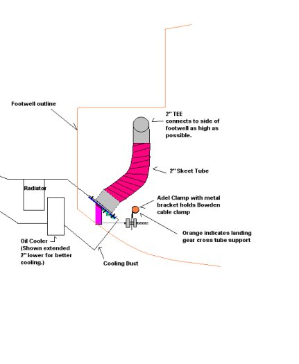

I also plan this sort of installation (http://www.customflightcreations.com/id18.html) this winter, thus cannot yet post my experiences so far.
My (conventional Rotax 914) engine installation is also running cool at low OAT, therefore I installed a water thermostat (an additional oil thermostat might also be an option) - this should help a little.
Roland

PostPosted: Thu Oct 25, 2012 5:56 am    Post subject: Working cabin heater Reply with quote
Hi Roland
I have a similar set up in my 914 but without the water thermostat,
Using one will reduce the water temperature in the Radiator but will
Increase the engine water temperature only,
You would be better of fitting a cowl flap to reduce cold airflow through
The radiator so increasing air temperature behind the radiator then to the cabin,
My heater certainly takes the chill out of the air making flying pleasant down to minus 5 C,     but it isn’t as warm as the average car heater,
This I intend to rectify this winter’s maintenance layup with improved
Ducting and insulating the heat trunking to the cockpit
Ivor

<?xml:namespace prefix="v" /><?xml:namespace prefix="o" /><![endif]--> [img]cid:013f01cdb608$81649a60(at)goldfishbk2xxe[/img][img]cid:014001cdb608$81649a60(at)goldfishbk2xxe[/img] Photo E-mail [url=https://skydrive.live.com/redir.aspx?cid=2161856909618aa7&page=play&resid=2161856909618AA7!282&type=5&authkey=!AGSy0jMk4aIkbhI]View slideshow [/url]| [url=https://skydrive.live.com/redir.aspx?cid=2161856909618aa7&page=downloadphotos&resid=2161856909618AA7!282&type=5&authkey=!AGSy0jMk4aIkbhI]Download images [/url] Jacques,
I have been building a similar cabin heater for about 6 years.
It is fine until about -10 C. The duct has to be quite well sealed and since most of the heat comes from the oil cooler, if a thermostat is installed one cannot expect it to heat as much. In my experience my oil temps in winter run about 160F or 70C. The air out of the back side of the cooler is normally just under 100F or about 35C. N12AY is pretty tight and my air vents seal pretty well so little air rushes into the cockpit through the inspection holes and center tunnel as I have it all well sealed. Just the sun shine keeps me in winter clothes fairly comfortable. If I close off the oil cooler with a plate over it, that cuts the air flow too much.
Unfortunately, I am in Florida, so it rarely gets super cold here. The the mono tends to be drafty through the tunnel and is asking too much from my little heater (basically the same as the Europa Club mod).
[url=https://skydrive.live.com/redir.aspx?cid=2161856909618aa7&page=play&resid=2161856909618AA7!283&parid=2161856909618AA7!282&type=1&authkey=!AGSy0jMk4aIkbhI][img]cid:014101cdb608$81649a60(at)goldfishbk2xxe[/img][/url]
My only suggestion for a constant high temp source is to pull the coolant from the engine using a similar hookup to the carb heat mod, and use a small oil cooler (or a simple 3/16 inch copper tube coil and fan in the cockpit to bring up the temp for bitter temps.) Where to put it becomes a real problem.
I have not been a fan of pulling heat from a muff from the muffler or exhaust system as it is a Carbon Monoxide problem so I will not comment.
Sorry I can't help any more.
