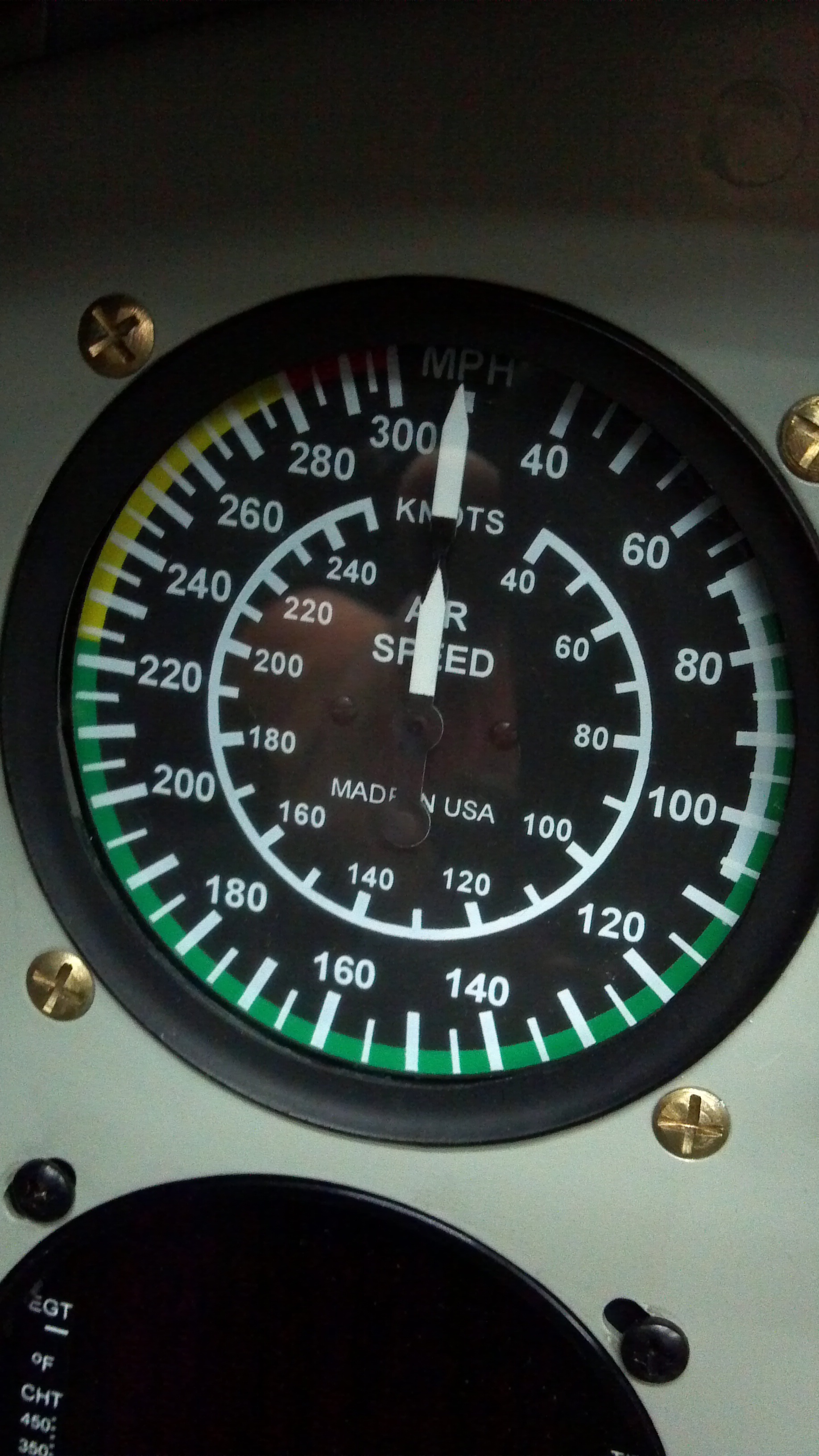

PostPosted: Fri Oct 12, 2012 8:52 am    Post subject: Re: AD notes for Yaks & CJs Reply with quote
The TW 'S Airspeed indocators in the US are in MPH and KTS.

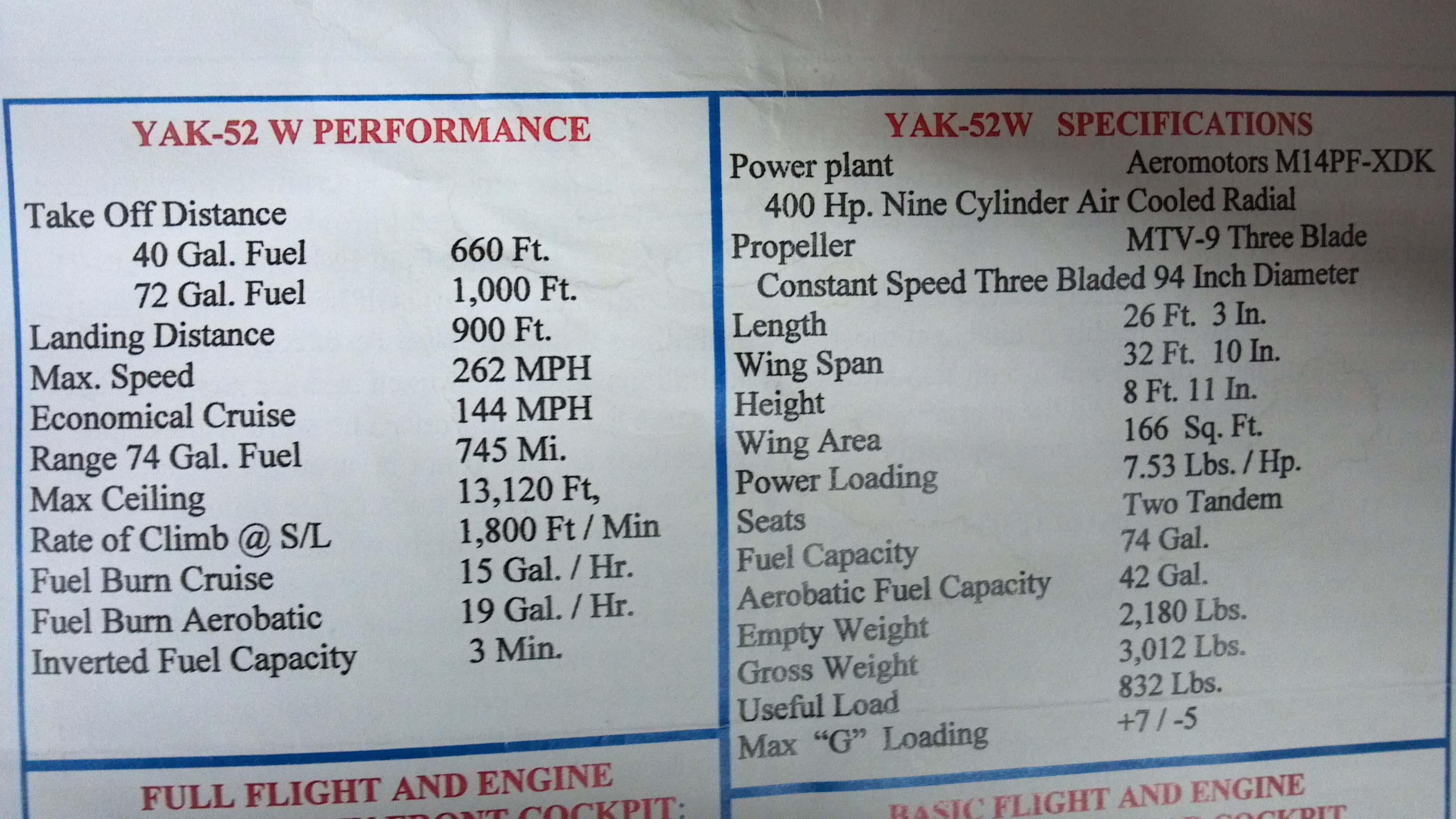

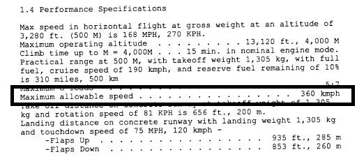

PostPosted: Fri Oct 12, 2012 9:12 am    Post subject: Re: AD notes for Yaks & CJs Reply with quote
The range markings on all the Westernized Yaks are dubious.
Compare the oil temp limits in the W to the "book" and they are way off in the ones I flew. Same with ASI
That ASI says your VNE is 450KmPH which is nearly 100KmPH more than the VNE for a Yak 52.
Note the correct Yak VNE is 223mph which corresponds to the beginning of that ASI Yellow Arc.
Yak 52 Tech Description says 360
Yak 52TW Tech Description says 360
Yak 52TW Flight Manual says 420
That installed Airspeed says 450
Beware translations in Yaks
YMMV..
Tj
Yak 52 Flight manual says 420
Yak 52 Technical Description shows 360VNE
 Filesize:  62.76 KB
 Viewed:  12817 Time(s)
