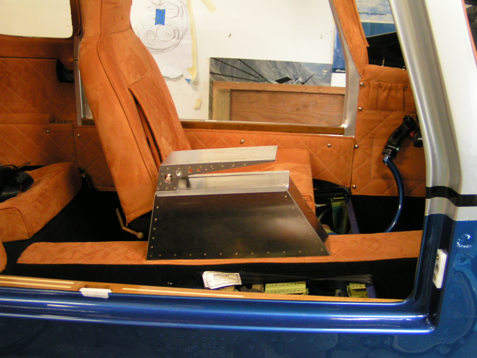

Mike,
I will let you determine if what I did is nice. It is .060 aluminum (i think, same as panel) riveted together with angles on the inside. It also has headset jacks in the front and a power outlet in the back. Not pictured is the armrest pad on top. I did not ever cover it in carpet or cloth I left the sides polished aluminum. There are angles on the bottom which 4 bolts go through to nutplates on the tunnel cover. To remove the console I just reach inside it and remove the 4 bolts. Since headset jack wiring is inside I have a CPC to disconnect that wiring and the power outlet. More photos upon request.
-Chris Lucas
N919AR

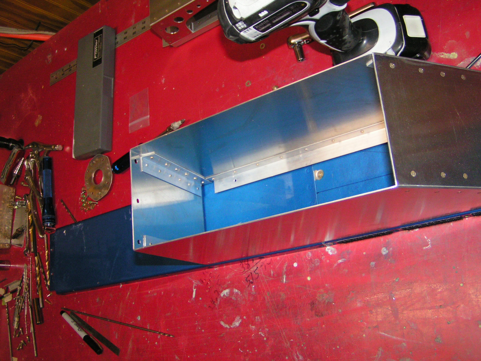

PostPosted: Sat Oct 13, 2012 6:28 am    Post subject: Home made center console? Reply with quote
Another picture. Also I used the angle on the bottom so I could drill different positioning holes if I didn't like where it ended up fore and aft.
-Chris

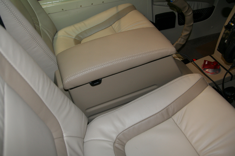

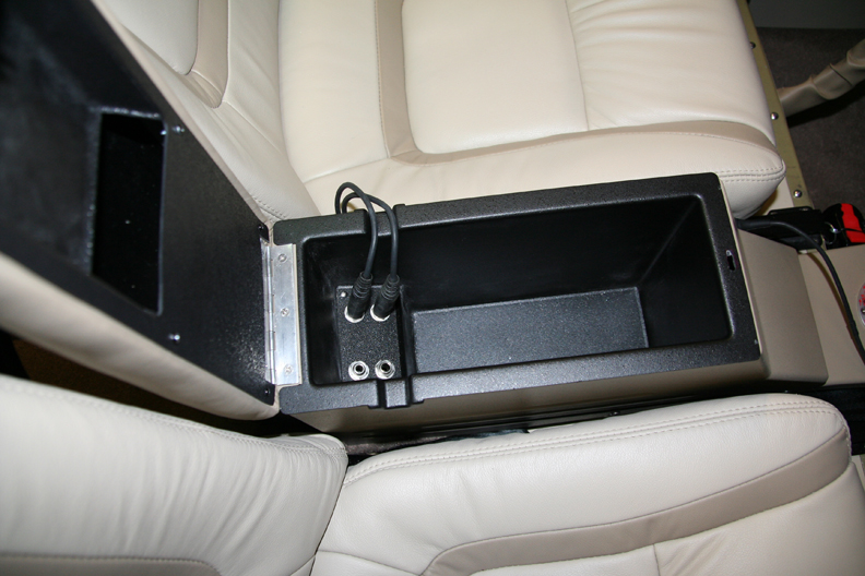

Michael you might be interested in this
I have a aluminum center armrest console which is just like the Carbon fiber
ones Aerosport
Sells. This was a prototype I only made one. I need to sell it and it would
make a great addition
For anyone looking for a center armrest. It comes with the interior bucket
as well.
Cost is $300.00 includes ground shipping anywhere here in the Continental
US.
Picture of the aluminum armrest and carbon fiber armrest
Geoff
