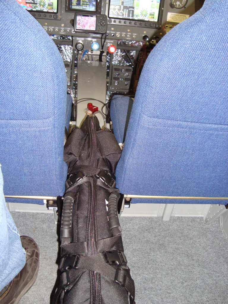

I was going to back fit an armrest in the plane, but then found the top of
the tunnel was a perfect place to mount a portable O2 system from Mountain
High. Using the provided cylinder carrier and straps, you end up with a
four buckle easy in/out install for the large O2 cylinder system (the
AL-682). The straps attached to the in place tunnel cover screws so no need
to add new holes. I used a tinnerman washer under the four screw heads.
The provided carrier pockets store the O2 Pulse Demand unit on one side and
the finger oximeter on the other. Tested up to 17.5K.
