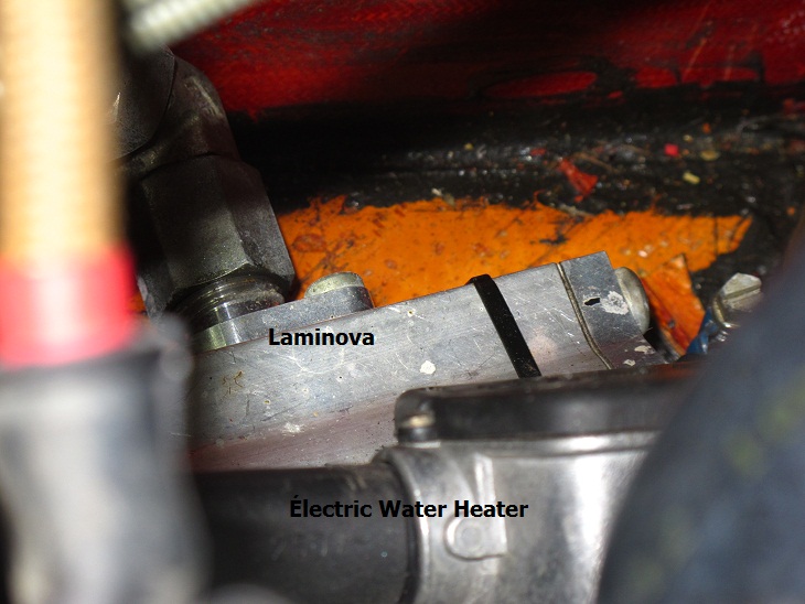

3. I am far from impressed by the cooling set up, and I know that
lots of people have modified the standard system. Has anyone used
the Laminova oil to water cooler, and if so, which size did you use,
and what was the result?
I have the Laminova heat exchanger with great results, but I have
entirely changed the rest of the cooling setup as well. Provided you
have a highly efficent water cooling, the Laminova has the benefit of
tightly coupling the oil temp to the water temp (reducing stress in the
engine) and allowing superfast oil warm up times without having to
resort to an oil thermostat. It also makes it less complicated to get an
efficent engine cooling; you only have to focus on getting the water
cooling working ok, designing a proper ducting for it, and have one cowl
flap to control both the temperature of the water and oil.
For the 914 you need the larger Laminova with a plug in the coolant
hole, there is a special light weight version of the Laminova availabe.
Beware, due to the tiny canals in the Laminova, you can't use the Evans
coolant. 50/50 works very well though.

Raimo,
Do you have any photos of the Laminova unit installed?
Jerry

PostPosted: Sun Oct 07, 2012 12:00 pm    Post subject: New to List Reply with quote
Hi Jeremy
I took this photo today after an interesting CO-flight. Shit happens regularly.
My Laminova locates very low behind the engine middle between the pedals on the firewall "shelf" under the airbox and it is very difficult to see w/o taking at least an airbox off (I didn´t). Over it you can see an electric (mains 230VAC) water heater for winter operations. Very near - a bit upp and port side -  there is also a water thermostat.
I hope this helps.
- Raimo
