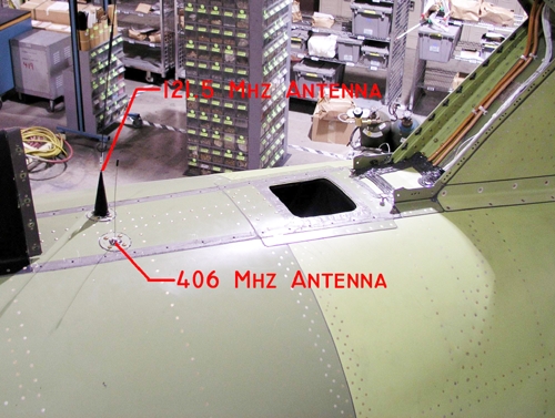

From a purely technical perspective:
If this were a legacy 121.5 "hope it will work"
type ELT, then any VHF comm antenna would perform as well
as the 'stock 'antenna supplied with the ELT.
The modern two-frequency ELTs require either two
separate antennas (like those on the Beechjet)
[img]cid:.0[/img]
Or a muti-band antenna tailored to the task. It's likely that
ANY 121.5/406 antenna would work just fine but given
the relative level of understanding by any individual likely
to take regulatory notice, likelihood of getting a
substitution approved is very low.
They are skilled in the reading of labels and checking
of boxes on forms, not skilled judging the suitability
of any substitution to a task.
