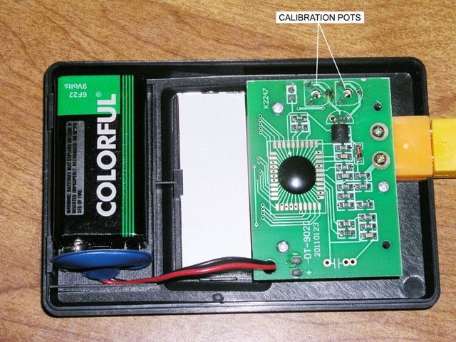

The critter was pretty close at 0C but off by 5-6 degrees
at 100C. I opened it up and didn't find any calibration
provisions.
The TM902 was a pleasant surprise. Not only was it within
one degree at 0C (stirred ice bath) it was equally close
at 100C (boiling distilled water). Even better yet, a peek
inside revealed not only an active cold-junction correction
device but two calibration pots.
[img]cid:.0[/img]
Bottom line is that this particular instrument is a great value as
a test tool for in-flight temperature surveys, it's easily re-calibrated
should this be necessary in the future.
It comes with a K-type thermocouple about 3' long. Uses standard T/C
connectors. The K-type wire is readily available from sources like eBay
and Omega. The low cost and re-calibration convenience of this critter
puts good temperature measurement and test capability in everybody's
hands.
