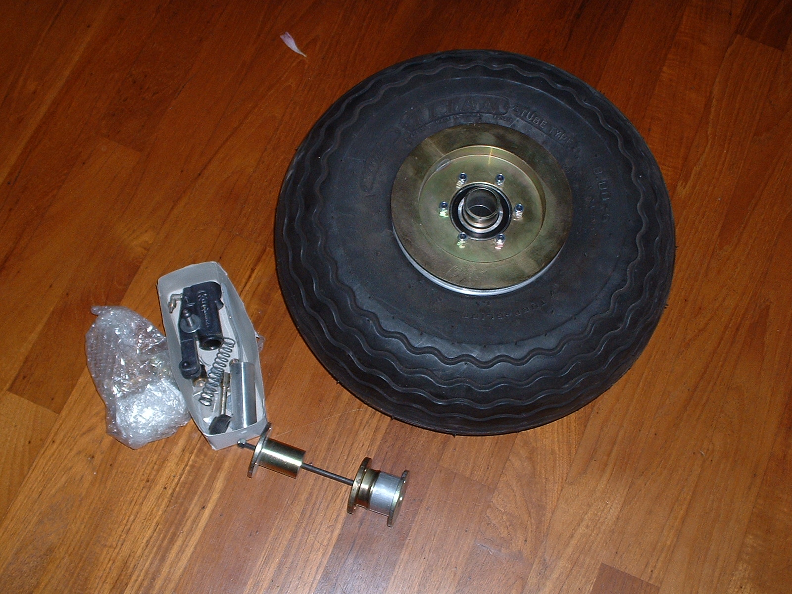

PostPosted: Sat Sep 29, 2012 1:21 am    Post subject: beringer wheel & brake for monowheel Reply with quote
Remi,
I weighed the bits on the picture together, making 10.8 +/- 0.1 kg.
The tyre is the original Europa one. It says:
TITAN, tube type, 4 ply, 8.00 - 6, turf glide, not for highway use.
I wonder how many flyers have used this tyre in operation and for how long.
Jan

PostPosted: Sat Sep 29, 2012 3:27 am    Post subject: Re: beringer wheel & brake for monowheel Reply with quote
Thanks Jan,
As far as I remember this Carlisle tyre weighs about 0.7 kg less than the AirTrac 8.00-6, when new. Based on your figures, that means that for those already using the AirTrac the weight saving provided by the Beringer kit would be in the 2.2 - 2.7 kg range. A significant portion of this saving (0.9kg) comes from the removal of the tube, as this is a tubeless system.
Remi
