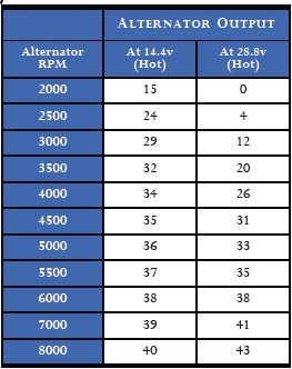

Borrowing from the B&C website we see this data
table:
[img]cid:.0[/img]
Assuming 1:1.4 step up gearing for the vacuum
pump pad, a ramp taxi RPM of say 1000 yields
alternator RPM of 1400 where it can be
expected to deliver less than 15A. If bus
loads on the Aux alternator are significant,
bus voltage on that side can be expected to
drop below 13.0v warning value and the battery
will be expected to pick up some slack at voltages
similar to those you cited.
