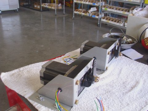

To those who has autopilot, where do you mount your roll servo? Pictures?Thanks in advance,
Robin

On the several APs we mounted, we developed a mounting bracket that attached to the belly of the aircraft. We spent A LOT of time with this and feel like it is a pretty good solution. See attached.
I highly recommend the Dynon AP. The installation is straight forward, and they work well. Again, we are a Dynon dealer and offer a discount to Red Star aircraft drivers.

Impressive.
