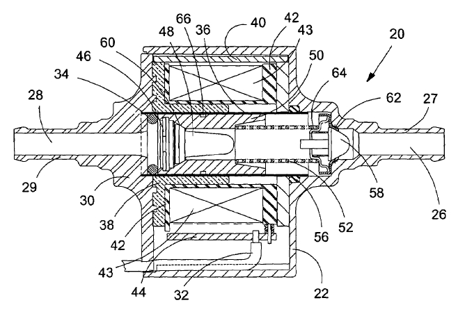

It all depends on the pump. On my Rotax 914 the standard arrangement is for two pumps in series, each paralleled with a check valve. In case a failed pump will not pass fuel there's a parallel check valve to ensure fuel flow.
[img]cid:A16AC493-1F3E-46DC-8400-B95D029C5247[/img]
Odds of a check valve failure are approaching zero.
You can make up a similar parallel setup with check valves on the output of each pump to ensure there's no back flow through a failed pump.

This is not an electrical question, but relates to the previous question
about fuel pumps. What are the pro and cons about plumbing fuel pumps in
parallel compared to series? My concern is the failure of a check valve
when fuel pumps are in parallel. The pilot might not be aware of a check
valve failure until its associated pump also fails. Then the good pump will
be circulating fuel in a loop through the failed check valve. The fuel
pressure to the engine could be reduced. Or is this concern unwarranted?
I would think that you would normally do a fuel pump test as part of
your preflight, i.e. turn each pump on one at a time and check pressure.
This will check the pump op and the check valve. It is highly unlikely that
you will have both a pump and a check valve failure simultaneously.
Has anyone explored the cracking pressures for the
two check valves built into Facet/Purolator style
pumps? As Joe suggests, the probability of failure
for a check valve (48 and 5Cool is very low. It might
stick OPEN due to some obstruction and filters are
supposed to stop that.
[img]cid:.0[/img]P
For a pair of pumps plumbed in series, it seems that either
pump would function with the other powered down unless the
cracking pressure for valves in the inactive pump are too
great and a low-pressure by-pass valved is called for.
These pumps are MOST likely to quit due to lack of power.
Given their all solid state, free-running excitation philosophy,
See: http://www.freepatentsonline.com/7150606.pdf
. . . there is no part of this pump that is highly stressed or
subject to wear. Dual pumps would address a HOST of ancillary
failures like broken wires, bad switch, bad breaker, loss of
buss, etc. Two, totally independent pumps/controls/protection/
power source pretty much covers the bases. This extra plumbing
and check valve thing may be an exercise in unsubstantiated
worrying. Some simple tests would confirm/deny validity
of the concern.
