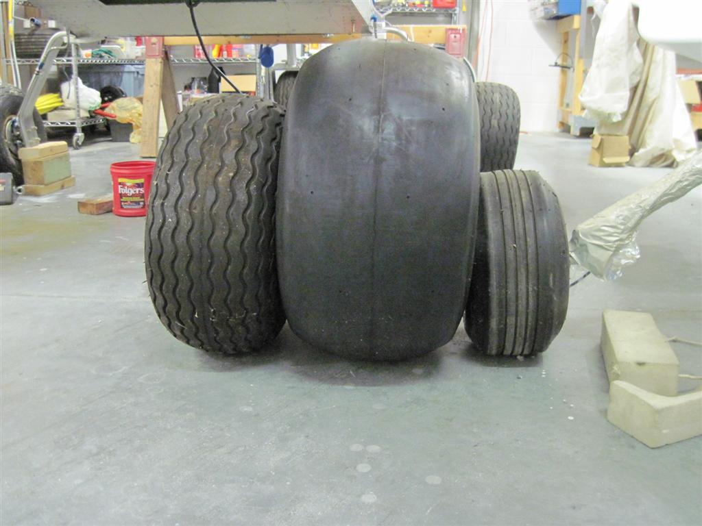

Now and again a topic on here comes up that I know a little about. The Tires that alot of people refer to as Tundra Tires are no where near to being anything like the original Alaskan Tundra Tires. The only characteristic the tires have that are similar to the real thing is being big, and actually they are not really all that big either. I have been selling a Tundra Tire set-up for a few years now, and they have many of the characteristic of the real ones. 1) Big 21"x 12" x 8" 2) light weight 3) soft and pliable. 4) smooth so they can slide and be more forgiving.... They are just like the real Tundra Tires, but just cost a friction of the cost of the original Bush Tires. If anyone needs any just send me a message. I can fix you up with the whole set-up. Tires, Wheels, and Brakes, or any individual item. The Wheels are Custom Made and Heat Treated, 8" Diameter and your choice of width. I use a Wheel that has a 9" width. I have even shipped out of the County,and I have them being used on Kolbs, Challenger's, KitFox., Avids, Rans, Ridge Runners, Phantoms even on some Trikes....l. Rotax Rick down in Naples Florida was my 1st Customer, and he Loved his
as you can see my Tires are much bigger, so called Tundra Tire on the Left, made by Carlisle

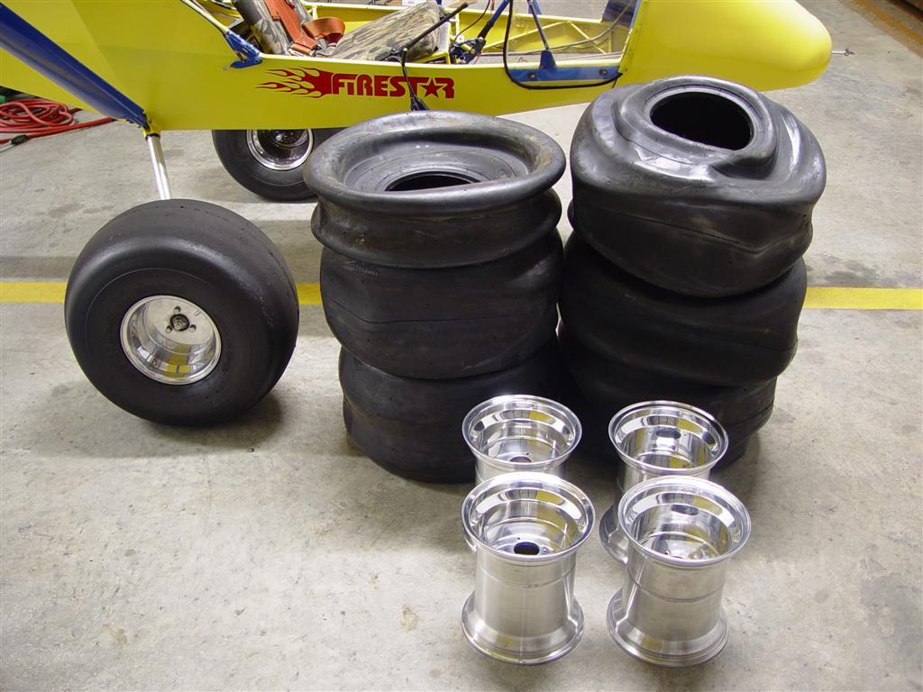

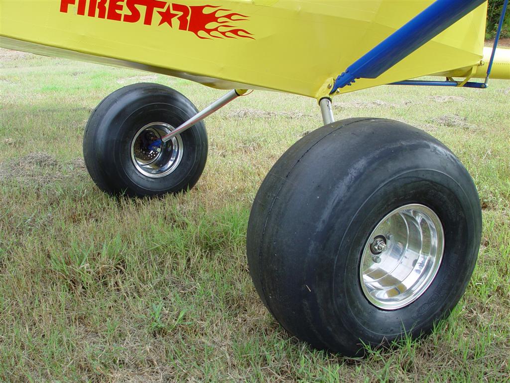

In this Picture you can see the wheels with two different off-sets

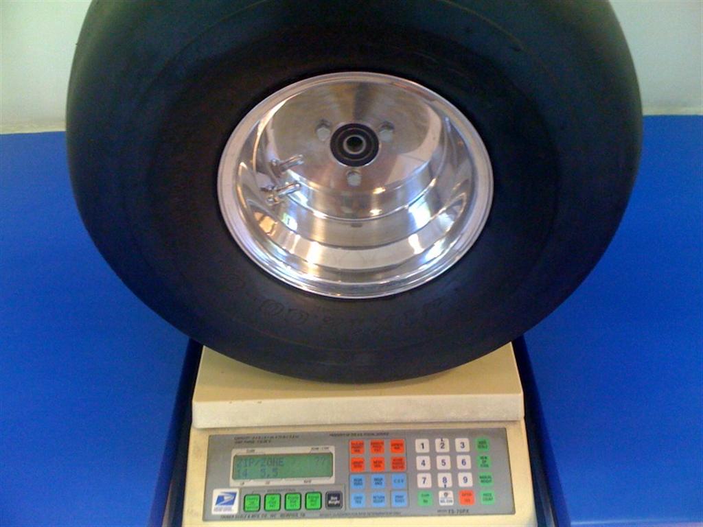

Here is a Picture of 1 Wheel with a Tire and the Black Max Wheel Hub on a weight scale at our local Post Office........... The price of the complete set-up is $779.00 plus Shipping Cost... I have always shipped the tires already mounted on the rims, that way I know the buyer will not have any problems. The complete set-up can be fitted on in less than an hour.
14 pounds 5.5 oz

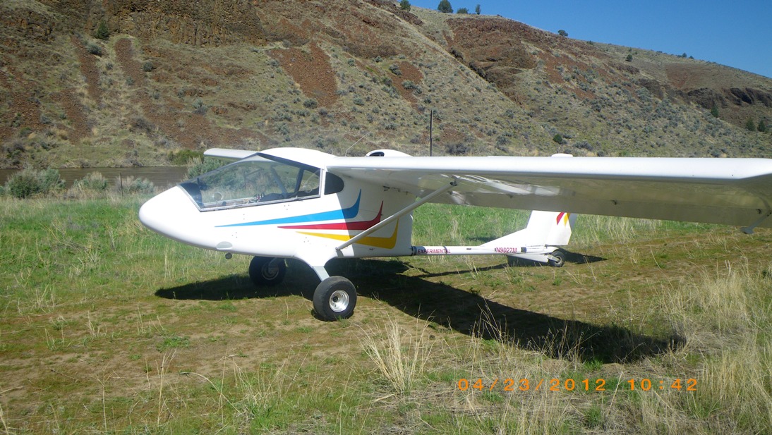

Attached is a picture of my aircraft with 21x7x8 shaved ATV tires on it. The rims are matco 8x6 rims. You can buy the tires from Dressler tire. I chose this instead of going the Nanking (nanco) 21x12x8 way because I felt I did not need the 12" of width (the ones I used are only 7" wide). I ran the tires without tubes and the set up was fairly light. This solution is more expensive than the complete set up being offered because of the cost of the matco rims.
Jason
