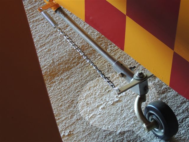

PostPosted: Fri Sep 14, 2012 10:34 am    Post subject: Re: Tailwheel upgrade Reply with quote
"is it worth the price"? A resounding Yes, best money I ever spent on my Kolb !

Dave, Glad that you decided on getting it from Kolb. One thing that you might find is that it breaks free too soon. I found that on a cross wind landing the wheel would already be "broke loose" before I even touched down, and if there is a substantial amount of cross wind, be a bit hard to control at taxi speed. ( I once did two 360's in the middle of a 10000 foot controlled runway much to the consternation of said controller, who seemed intent on forcing me to declare an emergency) ( the brakes got hot and wouldn't hold it in a straight line anymore)
My fix was to take a dremel tool and hog out enough material that it kept the tail wheel from breaking loose at anything less than full rudder. If you are trying to spin the plane around, the rudder will be fully deflected anyway, and that way any 360's will be intentional.
Your thoughts may differ,
Larry

Yes, the tailwheel upgrade is essential.  That pizza cutter is pathetic....
For my FireFly, I bought the one from Aircraft Spruce because it was in stock for immediate shipment and Kolb had none in stock at that time.  Bad mistake.....  The mounting hole in the Spruce unit is 1/2" while the tail spring on the Kolb is 5/8".  It's a difficult machining job because there's a square boss so it won't fit in a lathe chuck normally.  I took it to a well equipped machine shop and they had to mount it the chuck from the driven end but then it was buried so deep in the chuck that a conventional boring bar wouldn't reach, so they had to fabricate an extension.....  Cost $130 for 1 1/2  work...  So get it from Kolb ready to use.
Then I found the same problem as Larry, that breakaway swivel feature is a pain, and totally useless if you don't have differential braking....  So I also had to machine it out so that it doesn't release.  So what's the point of paying so much for all that mechanism just to get a wider tailwheel......  Besides, that assembly is heavy and designed for a much heavier aircraft.  Another problem with this mechanism is that the steering levers are much longer, so there's even less steering deflection at full lock, making it even more difficult to turn around on a runway.....  The arm is very hard steel so I couldn't drill new holes.
The original tailwheel mechanism on the Kolb is quite adequate, it's only the pizza cutter wheel that's the problem.  I noticed that the new tailwheel bearings would fit on the original axle shaft, but the axle wasn't long enough to reach right through the new wheel.  To do it again I'd just weld a longer axle onto the original mechanism and fit a new wheel on it.  Surely the wheels must be available as a replacement.
Sure would be good if Kolb would source those wheels and manufacture a replacement mounting that would just bolt onto the original mechanism.  Be a lot simpler, lighter, and less costly.....
JG

I have found the original tail wheel to be more than adequate. With a tail
weight of less than 60 pounds, it has held up very well. Due to long
taxiing on hard surfaces the tire wore away down to the plastic and I had to
replace it after 634 flights.
The only problems I have had are with the tail wheel springs and pivot bolt.
The first spring broke upon landing after the 635 flight and resulted in a
ground loop. Thinking that it was a fluke, I replaced it with a Kolb spring.
Fourteen flights later the opposite spring broke. Luckily it did not
result in a ground loop. This made me think about it a little more and I
decided to use clevis springs, but I could not find any that were small
enough to fit on the FireFly. So I resorted to making my own set up from
bicycle spokes and compression die springs. The advantage of this system,
is that there is little if any chance of the spring breaking.
During this refitting process, I discovered the steel on steel pivot bolt
and holes were badly worn. To repair it I re drilled all the holes and
inserted brass tube bushings and thrust washer and a new bolt. This took
all the slop out of the pivot.
The benefit from this effort has been that the FireFly ground turning radius
is much smaller that it was before. The compression spring setup is stiffer
and so the FireFly is much less squirrelly when taking or landing in cross
winds.
When I was building my FireFly I cut the tail wheel spring rod length in
half. I did this to save weight and to make sure I could make the 254 pound
weight limit.
If you would like to view these mod's, they can be seen at:
http://jackbhart.com/firefly/firefly133.html
and:
http://jackbhart.com/firefly/firefly41.html
Jack B. Hart FF004
winds.
weight limit.
and:
Jack B. Hart FF004
