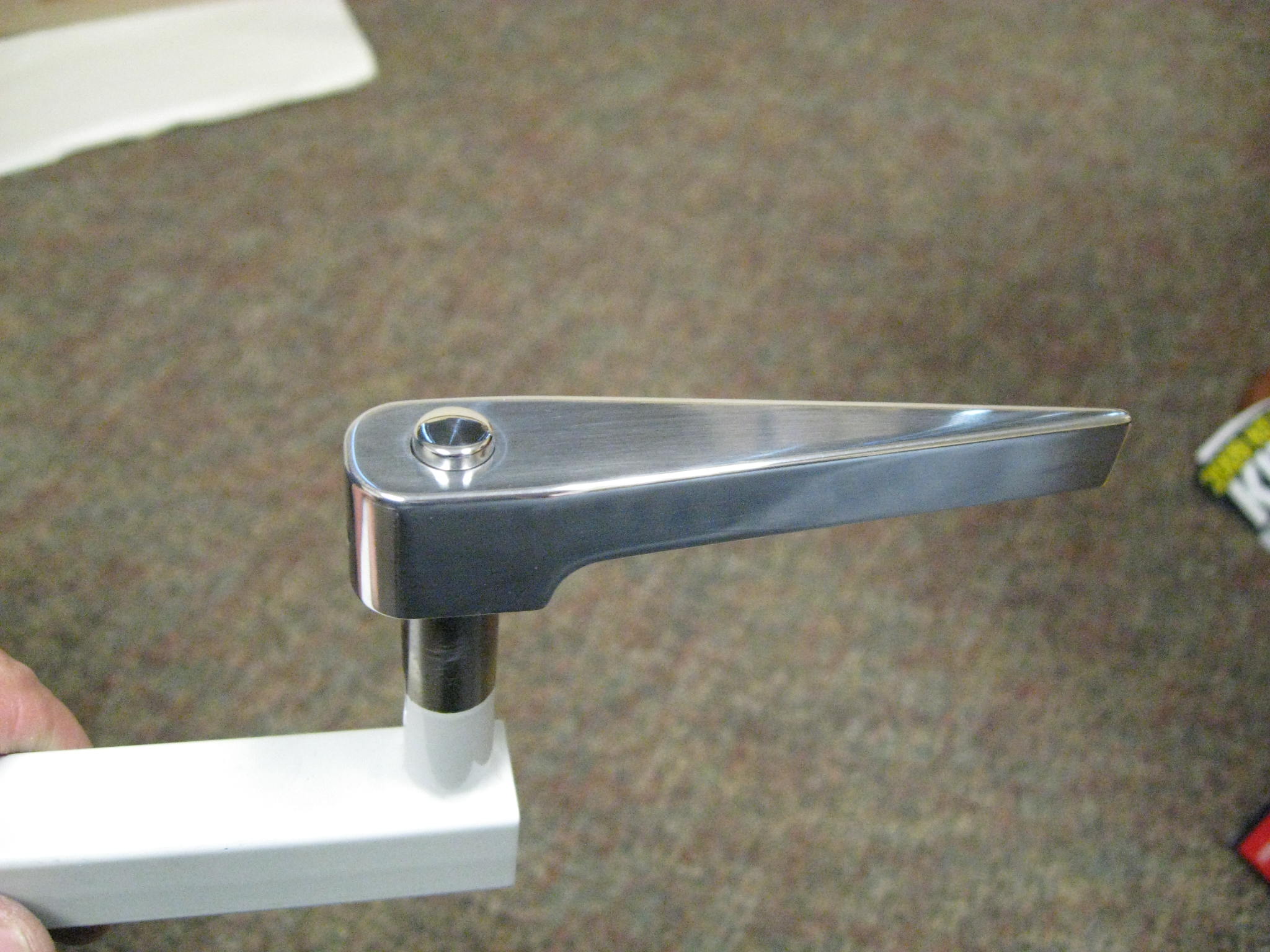

Here is what I did. Made a little aluminum cap that pressed into the rod.
Looks good and
Is easy on the thumb
Geoff

Geoff,
That looks really nice! And the polished handle looks very good too, well done. Just more stuff to add to my list of things to spruce up now that I've had the airplane flying for a number of years.
Marcus

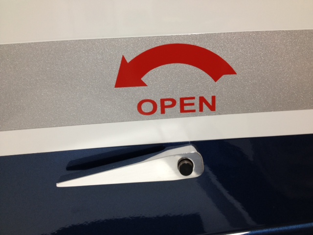

n223rv(at)wolflakeairport Guest
Posted: Fri Sep 07, 2012 7:18 pm Post subject: Button For Exterior Door Handle C-1007 |
Mine also have this nylon button. Came with my kit....
-Mike Kraus

amekler
Joined: 07 Oct 2010 Posts: 164
Posted: Sat Sep 08, 2012 4:07 am Post subject: Button For Exterior Door Handle C-1007 |
Mike,
Where did you get the door open decal?
Alan
Posted: Sat Sep 08, 2012 3:25 pm Post subject: Button For Exterior Door Handle C-1007 |
I purchased the decals from Vans, it's in their catalog.
On Sep 8, 2012, at 8:07 AM, Alan Mekler MD <amekler(at)metrocast.net> wrote:
Mike,
Alan
>>>>>> -Mike Kraus
>>>>>> RV-10 Flying
>>>>>> <image.jpeg>

Yes, that is how mine work. Sorry for the mistake. The picture I posted was of the pass side. It opens CCW. Pilot side opens clockwise. You need to buy one of each decal.
-Mike Kraus
