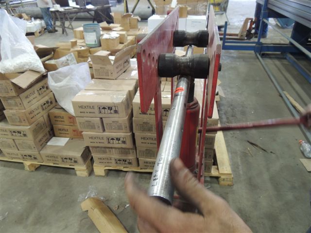

PostPosted: Sat Sep 01, 2012 7:21 am    Post subject: Re: Aluminum gear with 5/8 axles Reply with quote
chevybowtieracing ...it happens to best of us . Hang in there!
