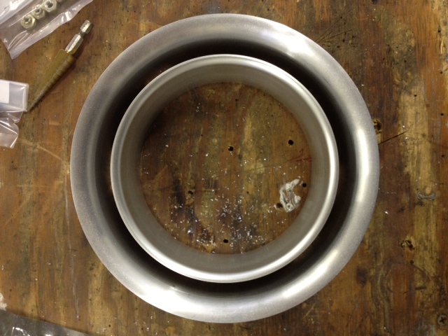

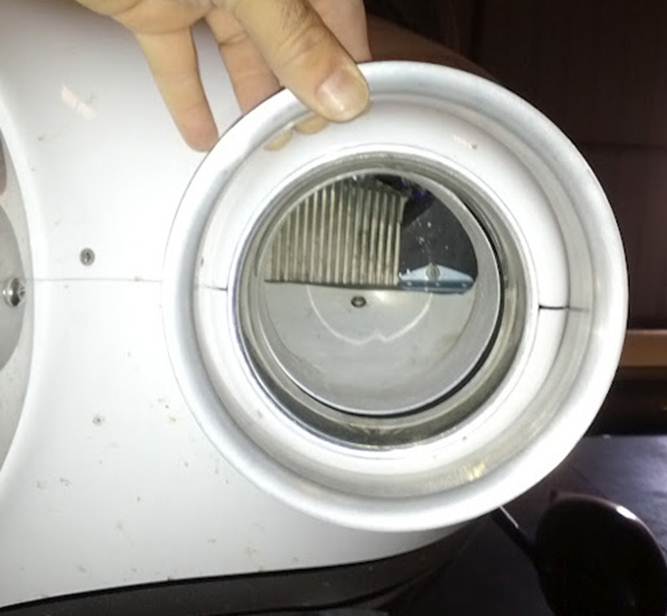

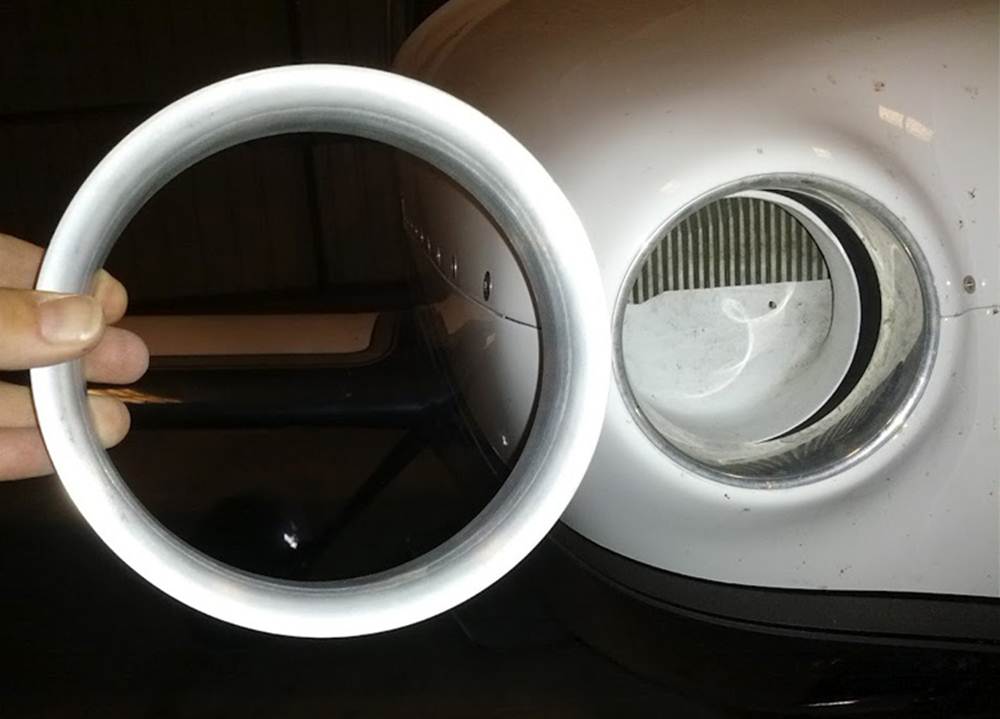

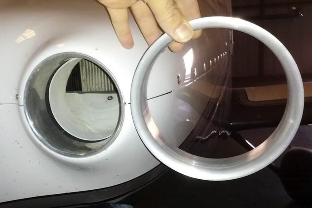

To continue our discussion of inlet ring size relative to engine cooling when I was last home I photographed the SJ inlet rings with the rings designed by Alan in Watsonville. Alan has had success in cooling by increasing the opening to his James cowl. I will not speak further about Alan's set up because I really don’t know the details other than he does beautiful fiberglass work. My point is look at how substantially different the two rings are in size. Yes I know, I need to clean the bugs off my nose.
Robin

1) That larger ring looks at least as big if not more than the stock van’s cowl J.
2) I’m wondering if you may be experiencing inlet drag/interference that is causing a blockage to the inlet flows. The slick/successful James Cowl’s have seen always seem to have more of a venturi style inlet shape that gradually narrows then opens back up.

I do not know about #1 but I suspect the rings are a bit larger than the Vans standard cowl. As far as #2 I have a James cowl on my 8A and they do not have the same issues as the -10 cowl. I don’t think I would call the 4 cylinder James cowl "venturi" style as they really don’t gradually narrow and the transition back is a function of how the builder chooses to make that transition. With so many variations on the 4 cylinder world and few problems I tend to lean towards overall size opening being the limiting factor.

Robin - thanks for posting. Those things look giant! I would think your entering the zone of external pressure recovery. I know you are absolutely sick of this whole cooling thing and just want to move on and get it solved. Before you do that is there any chance we could get you to take some before and after pressure measurements in your cowl? I know I am asking a lot of a guy who is as frustrated as you are.
By the way, as Ben said the interior shape of the inlet is really critical on internal pressure recovery type systems (small inlets) like the James Cowl & Plenum. I am of the unverified opinion right now that the interior shape of the James cowl inlet is the problem. Putting together the test plan and data right now to verify that.

They are considerably larger (at) 6.25 ID for about an additional 4.5 sq-in over the originals.
