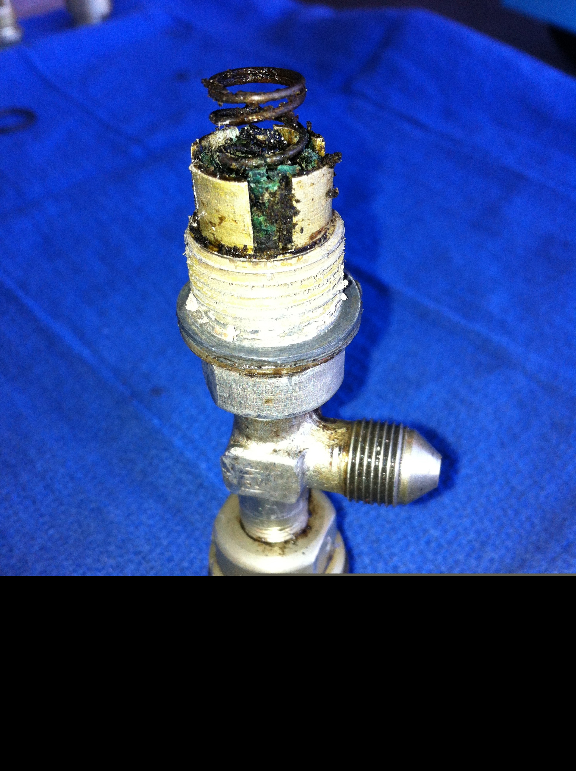

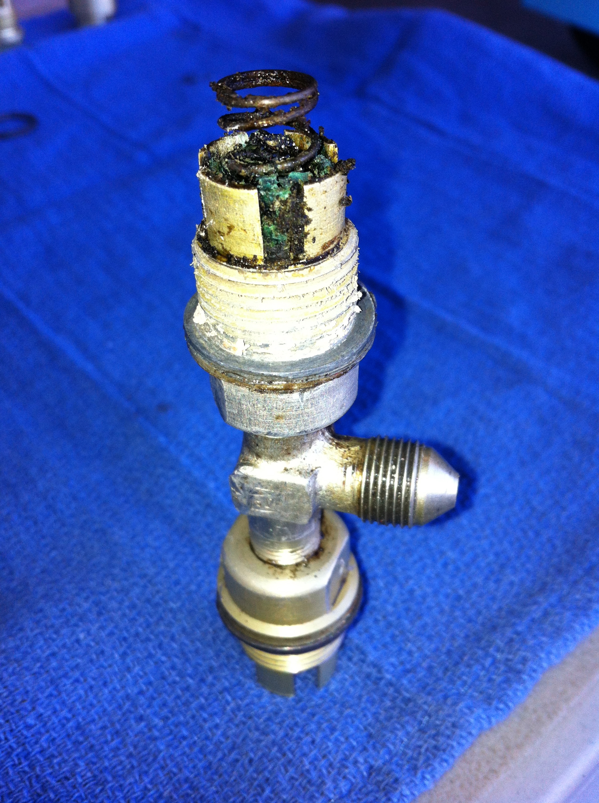

There are two possibilities. I had the exact same problem. If the gear fails to retract, you have a leak in the emergency system.
First, and most likely is one of the two emergency system check valves on the firewall. See the attached picture for what mine looked like. The other is one, or both of the two emergency air on-off valves in the forward and aft cockpits. You'll have to chase these systematically, but I would start with the emergency system firewall check valves. For me, it turned out that I had two bad firewall emergency system check valves and a bad emergency on-off value in the forward cockpit.
When you turn off the main air, it's not unusual for the main air pressure gauge to bleed down to zero after several hours. What matters is that when you turn back on the main air that it comes back to 40 ATMs. The emergency system air gauge should stay at 40 ATMs, or more, all the time.
If you would like some more detailed help, contact me off line and we can work through this.
Welcome to the CJ-6A. The tired old cliché is that flying a CJ is mostly to discover what needs to be fixed next.
Good luck with everything,
Warren Hill

First, take the slot apart and clean it. Having some garbage in the air system in plane new to the US isn't uncommon.
Second, you may have emergency air bleeding through to the down side. If so, the gear will not come up. Study the pneumatic system diagram and crack a nut on an emergency line to one of the main gear actuators. If air comes out, and it should not, you have a leaking check valve. Pull the check valves on the port firewall adjacent to the descendent filter. Chances are one of the rubber disks in the two valves has failed. It'll be obvious when you open them up. Doug Sapp has a kit which solve the problem. If your can find a recent Red Alert archived on the RPA web, John Long wrote a great article on the subject.
