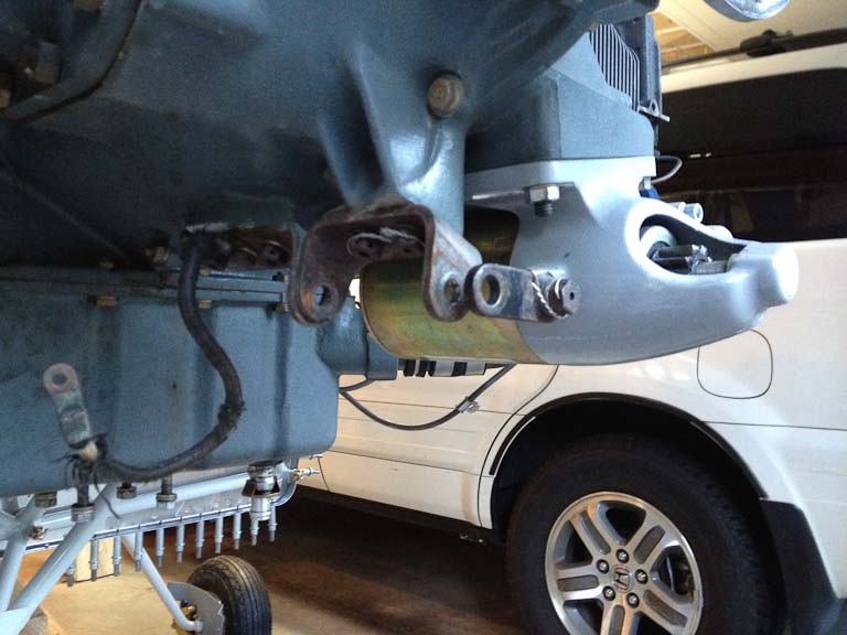

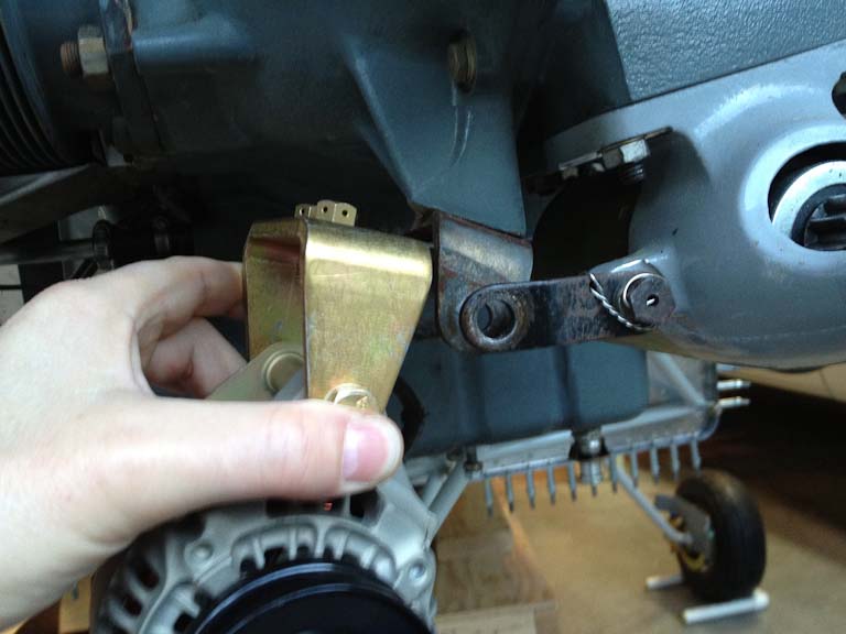

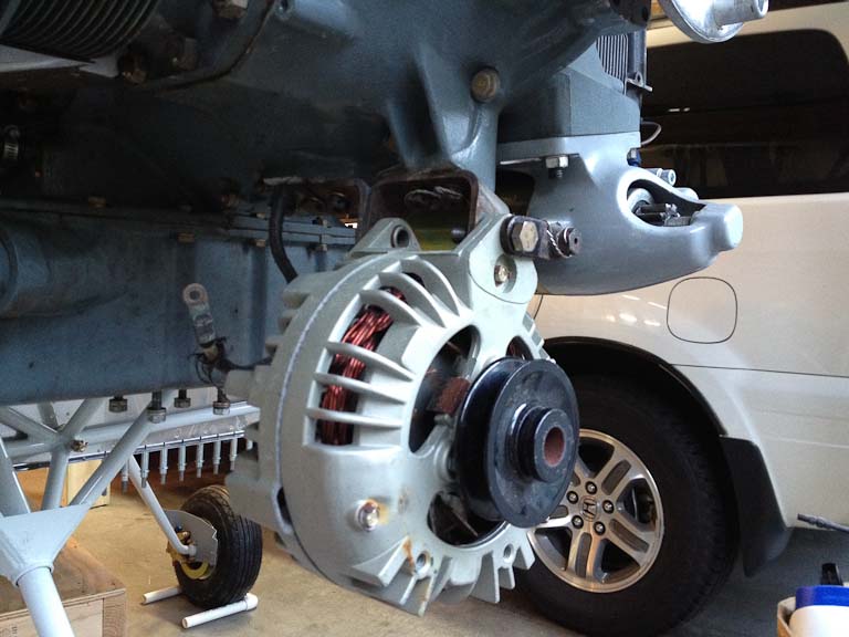

Folks,
I just got my "pre-owned" engine mounted to my RV-9A this week. The engine is an O320-D3G and it came out of a certified aircraft. It had a large certified alternator on it, made by Chrysler, interestingly enough. I purchased a B&C 40 Amp alternator to replace it. I thought it would be a direct replacement for the certified alternator. The certified alternator is boss mounted.
When I took the old alternator off and tried to put the B&C alternator on, I immediately noticed that the mounting brackets were very different. The old brackets consisted of three separate brackets. There's a long bracket in the rear, then one that the alternator hangs directly under and finally a strap that ties the starter to alternator bracket. All three brackets are much shorter than the single bracket that came with the B&C alternator. I've enclosed a few pictures.
Do I have to try and fabricate the rear bracket and the starter-altenator strap to match the B&C alternator? I don't really have the equipment or know how to fabricate steel brackets. The material is at least 1/4 inch thick.
Any help or suggestions?
Michael-

#1 - See if you can drill new mounting holes in the "U" bracket mounted to the case to reposition the bracket so that it will mount up with the attachment bracket on the alternator.
#2 If that won't work, see if you can find a steel spacer that will take up the space between the U bracket and the attachment bracket on the alternator. 1/8" inch pipe might work, cut to size with a hack saw, washers on each end. Then use a bolt of proper length to tie everything together.
The latter solution is not elegant, but should cause no problems.

I will call them, but it is not a problem of boss vs. case. My engine has a boss mount and the alternator from B&C is a boss mount. The problem is that they only supplied 1 of 3 pieces to the boss mount. Now it may be that the alternator is light enough that it doesn't need the other two pieces. I don't know if the tie to the starter is to support the starter or the alternator. And maybe the rear bracket isn't required for the B&C alternator. It that's the case it would be good for the instructions to mention this.

You are the proud possessor of the "Pig-n-Pancake"
starter-n-alternator configuration I cited in my earlier
posting. "Proud" is not necessarily a given, if
in error please forgive my presumption.
The setback distance (pulley centerline to front face
of mounting ears), overhang moments and tension arm
geometries in the world of alternators is a bag
of scrambled eggs.
If your existing bracket is 1/4" material -AND-
steel, then it's structurally sufficient. You can
explore its retention by putting a long bolt through
the bracket and the B&C alternator and use the
intended belt to see if the bracket/alternator
combination can be 'jeeped' for proper set-back
by crafting a set of spacers. The spacers should be
snug on the bolt and square, flat ends. Lathe-cut
parts come to mind.
If that works, check the tension arm geometry. That
part is easier to make than the brackets but again,
they're steel and not the nicest stuff to work with
using ordinary shop tools.
Depending on your $time$, talents and resources,
you might be motivated to order the bolt-and-fly
kit from B&C.
