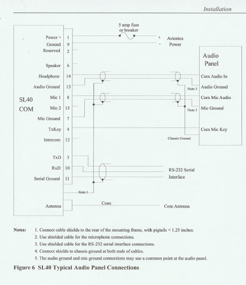

grosseair(at)comcast.net
PostPosted: Sat Jul 02, 2011 12:17 pm    Post subject: Ground loops Reply with quote
Thanks for the responses.
I misspoke about PS Engineering. They ground the shield at one end, but
here's the diagram for a Garmin SL40: You'll notice that they
specifically say to ground both ends of the shield to the case.
John

PostPosted: Sat Jul 02, 2011 2:35 pm    Post subject: Ground loops Reply with quote
but here's the diagram for a Garmin SL40: You'll notice that they
John
Okay, I'll bet you a dollar to a donut that
the "audio grounds" connected with wires are internally
grounded to chassis on both devices. Adding a shield
over a twisted pair adds no benefit for two devices
located next to each other. In this case, adding shields
and grounding at both ends is only redundant to the
ground-to-ground wire . . . hence, no risk.
You could just as easily wire these boxes up with twisted

The radio to audio panel issue is a bit harder to reconcile with the
'rule', but signal levels are higher there & the shield path is
typically so short that secondary return paths don't seem to be as
much of an issue. If you allow one end of the shield to float, and
let the return find its own path through the airframe, I'd bet that
you'd be creating the kind of problems that the 'rule' is trying to prevent.
I think the potential is already there with the 'audio
grounds' If the radio were, say, in a rear cockpit and
the audio panel in front . . . and the battery grounds were
in the tail, then there is potential for ground loop coupling
whether or not a shield is present.
That's not a very satisfying answer, I know. Maybe someone else can
give a more technically specific answer.
Most general aviation systems make prolific use
of chassis ground for both power and signals within
any given device. This generally not a problem for
small aircraft . . . especially when we go to some
pains to avoid noisy circuits circulating on the airframe.
Military stuff uses chassis ground only for shielding
where LOCAL bonding to airframe is desirable. RFI filters
grounded to chassis bring signal and power wires
in to dedicated, floating grounds within the device.
This makes is MUCH easier to manage ground systems.
So I guess I'd have to continue to say there are no
hard 'rules' for handling shields because we seldom
are privy to wiring details inside the black boxes.
If the schematic John provided us was for some really
'advanced' equipment, those paired audio lines would
be true balanced pairs and only one "low side" would
be grounded internally to inside the source box. The load
end would be totally floating with a ton of common mode
rejection. Shielding would still be of no particular benefit.
All we can do is the best guess and then go after a
noise problem should it happen to pop up. Our best guess
is adequate probably 99% of the time.
What we can say for sure is that all the schematics
showing shields that are not part of a return path
could easily be replaced with a wire. Shielding has
essentially zero probability of added value in our
working environment.

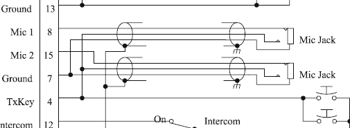

PostPosted: Wed Aug 29, 2012 3:07 pm    Post subject: Re: Ground loops Reply with quote
In the example above with the SL-40 and the audio panel, would it be acceptable to go to pin 13 & 14 with a shielded double wire and ground the shielding per Note 1 at the radio rack, leaving the shielding at the audio panel end free? I'm about to do a stand alone SL-40 installation with no audio panel and the install drawing for it shows the shielding also grounds at the jack ends as well as per Note 1.
Dan
PostPosted: Wed Aug 29, 2012 3:16 pm    Post subject: Ground loops Reply with quote
At 06:07 PM 8/29/2012, you wrote:
--> AeroElectric-List message posted by: "stearman456" <warbirds(at)shaw.ca>
Dan
[img]cid:7.1.0.9.0.20120829181047.01e1cff8(at)aeroelectric.com.0[/img]
There is no value in connecting both ends unless
the shield is also a signal/power conductor. Since
this is not the case, connection at one end only is
sufficient to reap the benefits of shielding but
connection at both ends in this case is unlikely
to be troublesome.
