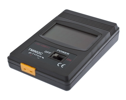

specific meters too. I've ordered one of these
critters off eBay
[img]cid:.1[/img]
. . . $5 delivered to my door. I'll see how accurate
it is . . . and how well it compensates for local
ambient (cold junction issues). In ANY case, I'll
bet it is a useful trouble-shooting tool for seeing if
an installed thermocouple and associated wiring is
in-the-ball-park okay.
