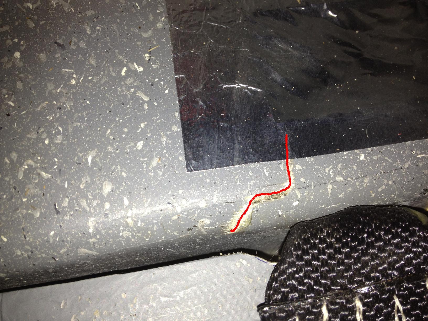

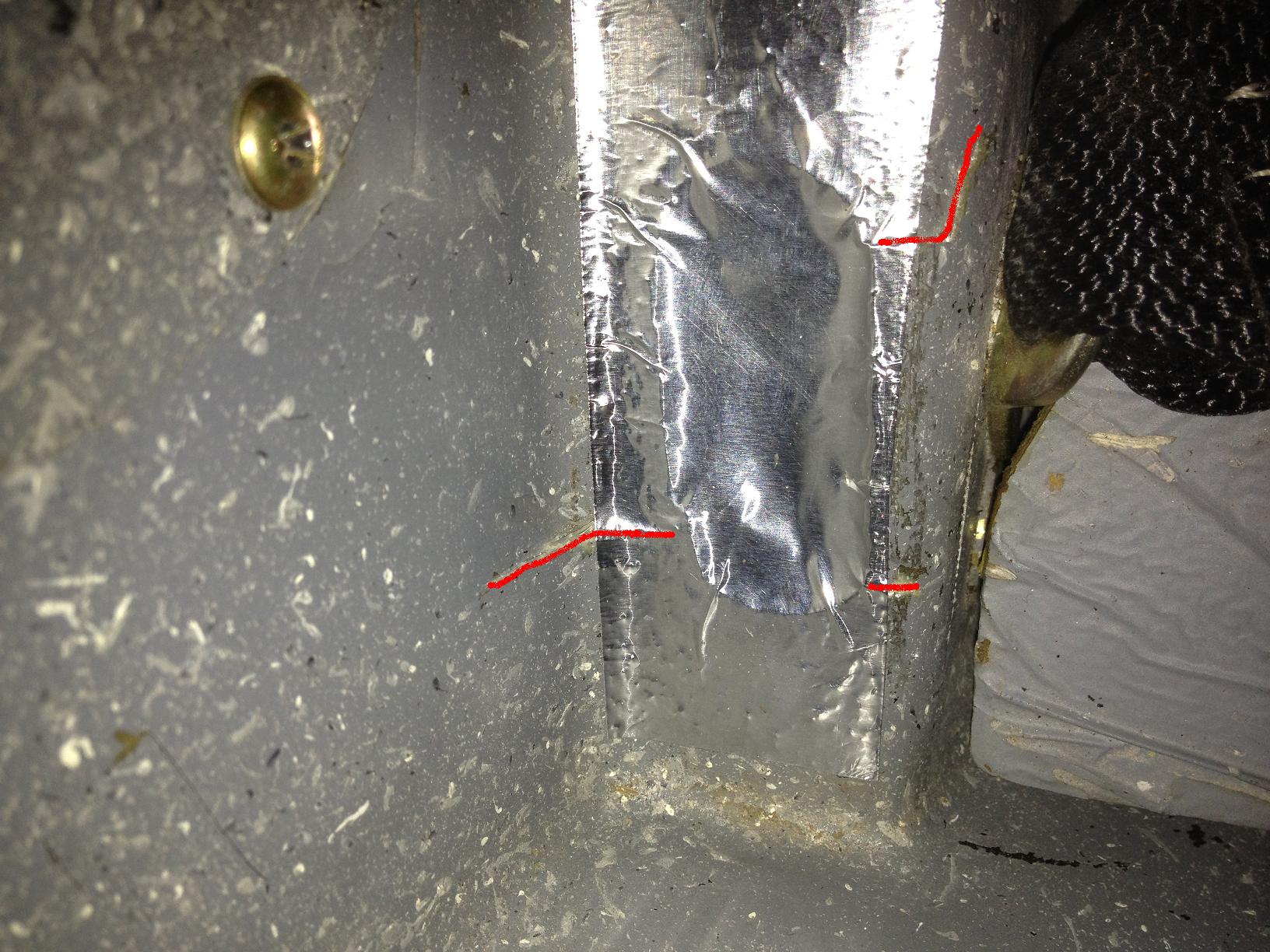

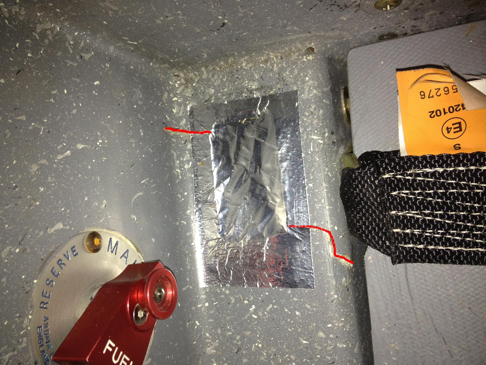

Hello all,
Doing a thorough check today, I found some cracks on both side of the central tunnel near the seat belts (see pictures). I would like to understand the gravity of these ones. I see the following options:
- my aircraft is grounded till repair (my current assumption)
- I can continue to fly with checking if the cracks are not further progressing after every flight
In order to repair, what do I need to organise?
- a new cockpit module -> that seems to be a drastic repair and maybe not even possible without separating the bottom from the top of the plane
- a local fix, but how to ensure structural integrity in this case?
I am not the builder but can find experienced people in fiberglass work (glider repair expert).
The plane is a monowheel. I got a gear up landing last year, about 40 hours ago. I see this one as the root cause of the cracks, but I could be wrong.
Any advice is welcome.
Jacques.

Hi Jacques, there is no pictures in your message

Hello all,
The plane is a monowheel. I got a gear up landing last year, about 20 hours ago. I see this one as the root cause of the cracks, but I could be wrong.
Jacques.

Hello, do others see the pictures? I checked with Explorer and Chrome and both show me the pictures.
Thanks for advice, Jacques.

PostPosted: Fri Aug 24, 2012 12:22 am    Post subject: Cracks on the cockpit module near to the seat belts Reply with quote
Jacques Hi.
Yes I do see the pictures embedded in my Apple Mail Note.
Any chance of one photo with out the red 'highlighting' to see 'as is'.
Gerry
gholland(at)content-strea
PostPosted: Fri Aug 24, 2012 12:26 am    Post subject: Cracks on the cockpit module near to the seat belts Reply with quote
Jacques
Pictures all open in Safari on a Mac from mail note URL.
Gerry

PostPosted: Fri Aug 24, 2012 11:43 am    Post subject: Re: Cracks on the cockpit module near to the seat belts Reply with quote

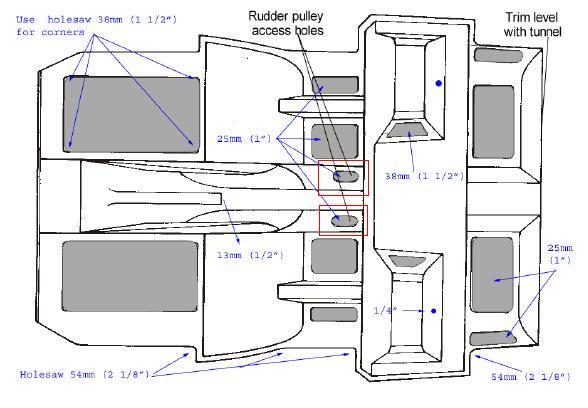

one thing I don't understand about the pictures, it looks like you have taped over slots in the tunnel which have become stress points, what are these?
I would have thought you could just clean out any damaged fibres, rough it up and add 4-5 layers of BID to cover the area including those holes, maybe to 120m -150mm from the mounting hole and drill the hole again, maybe bonding in a new penny washer. If you could get any BID on the inside that would be best.
Jacques,
Your pixs are a bit confusing to me as well, though I interpreted the "taped over slots" to be the small access holes for viewing the rudder cable pulleys. If your pixs show what I think they show, you should be able to add some BID on the opposite side by reaching up thru the wheel well and / or reaching in thru the fuel valve access panel. Having made these comments, I nonetheless refrain from making any recommendations as this situation is way outside of my knowledge base and experience.
I hope others w/ the requisite knowledge, experience, and skills will offer some suggestions for you.

Hi all, here is a drawing of the cockpit module that shows with red rectangles the place where the pictures have been taken and so the location of the cracks. Will 5 BID at both side of the existing panel and on the cracks location be enough to repair and prevent reoccurence?
Thanks, Jacques

During a monowheel collapse, the weight of the aircraft (less tailwheel and
outrigger loads) is transferred from the monowheel in to the top of the
'tunnel'. Thereafter, the stress-path from the tunnel is mostly both
forwards and aftwards. In the aft direction the tunnel distributes loads in
to the seatback bulkhead then further in to the fuselage skin. This means
that the area that has cracked (being at along this stress-path is taking
abnormal loads and this is a possible cause of the cracking, as you have
surmised, compounded by the holes that have been cut at that point.
Assuming there is no evidence of any other overstress in that area, the
repair needs to put back the strength lost. This means replication of the
original strength of composite in that location, which can be determined by
counting the number of plies present. Allow a minimum 1/2 inch per ply
overlap on to the surrounding unaffected area (presuming a bond shear
strength of 500psi and cloth strength of 250lbs/in) with staggered edges. If
the holes must be recut, then double the reinforcement and cut the holes as
ellipses (at a length:width ratio of 1.414:1, if you want to be pedantic!).
Too much or overdesigned reinforcement may make the area too stiff and
introduce other issues, and makes the aircraft heavy too!
Your respective airworthiness and/or design authority will be the final
arbiter of any repair, which might be along the lines of the above.
Duncan McF.

As others and you suspect, the crack was the result of the gear up landing and the main wheel and arm impacting the top of the gear well (and the choke, throttle, locking arm and all the other stuff) and forcing the module to bend upward. The aft bulkhead to rear back rest distance is short and the stress looks to be a tension crack.
The area should be de-painted by sanding carefully to the upper layer of glass and the glass properly inspected as well as the Redux (Araldite 420A/B) joints in that area. Rudder cable, fuel lines, etc. should be removed to provide for proper visual inspection and repair...
The layup repair is similar to any composite repair. Grind down the crack and taper. Fill the foam with flox and glass with 2 layers of bid inside and out with the overlap to be at least 2 inches either side of the crack. Delamination of the Redux joints in the module must be checked also. Tapping with a large coin or drift can detect a hollow sound and possible delamination of your glue joint.
I prefer not to paint the interior of an airplane but it is expedient as an interior, however, it makes inspection more difficult and can hide damage.
I do not have a specific gear up landing checklist for my guys, but I have them use our hard landing checklist to start, which is attached.
Basically, on a gear up we remove the gear and inspect and repair the well and cockpit, because there is a good chance damage has occurred unless the collapse was very benign.
Please to a de-paint and do a thorough inspection. Tape up the instrument panel or remove it and grind away. There is a 50/50 chance that this is the only damage. However I'm unlucky and a 50/50 chance seems to be a 100% chance of more problems.
