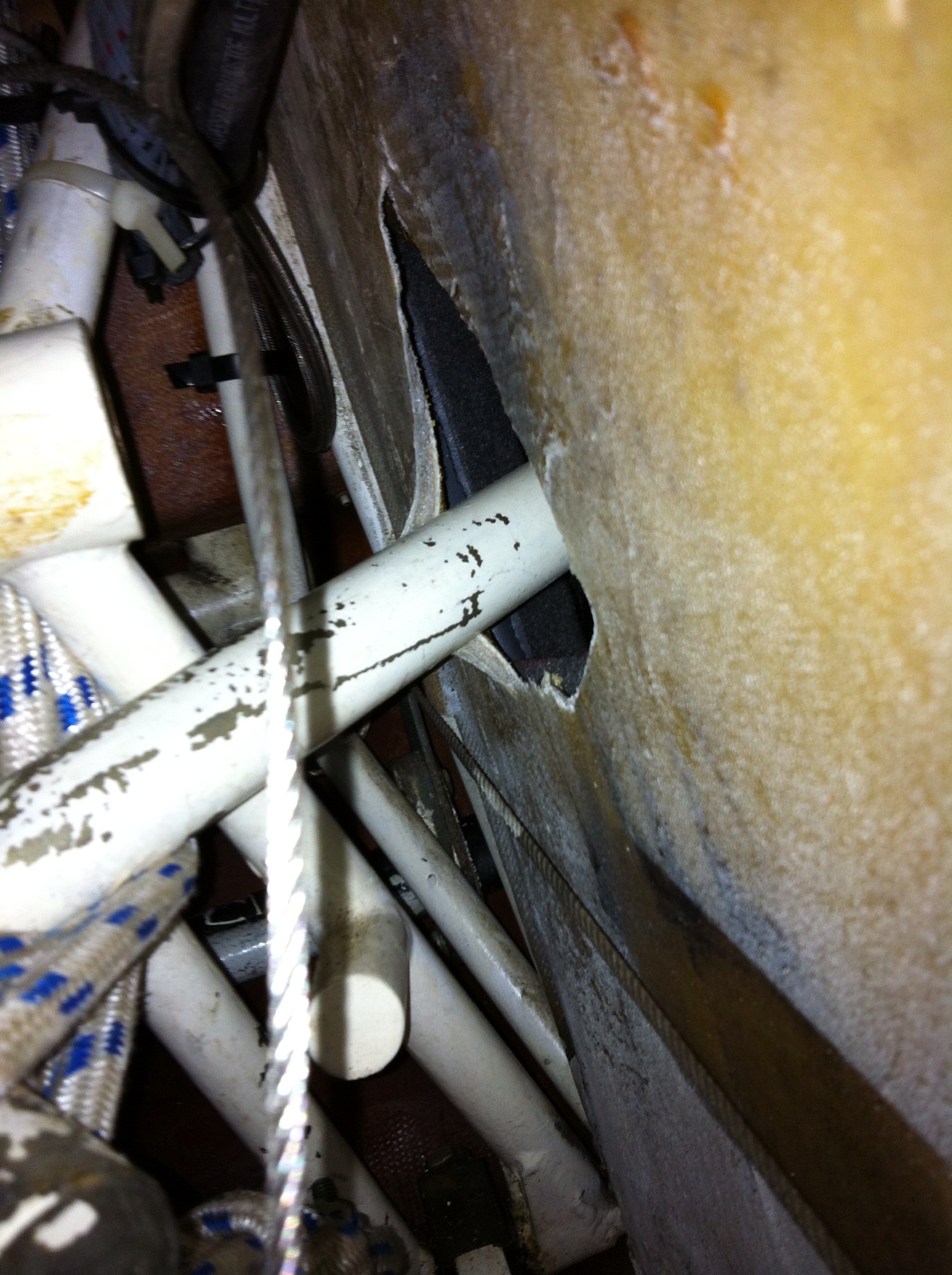

Last Monday I had a landing mishap on Texel (EHTX), resulting in a nose wheel collapse after a bounced landing..
Before asking my questions, I would like to express my BIG THANKS to Frans and Illona who drove their trailer up to Texel and drove PH-MZW back by road and ferry boat to my home base. Frans and Illona, words will always fall short when describing our gratitude! Also may thanks to Tim who phoned me up offering any help I would need!
First examinations showed that propeller and nose gear leg are beyond repair. Lower cowling got some minor cracks. After I removed the cowling and the covering plate of the cockpit tunnel, I found another piece of damage: evidently the nose leg had rotated appr. 45 degrees in the nose gear leg tube, which resulted in the bump stop having pierced more or less sideways through the tunnel appr. 1" into the passenger foot well (see attached image).
My questions to the forum:
(1) How much structural strength does the pierced part of the tunnel take, and what procedure do you recommend for the repair?
(2) I am planning to have a complete new nose gear leg assembly installed. Unknown at this moment is how to check the integrity of the landing gear frame. All suggestions are welcome!
(3) Of course I will have a professional Rotax maintenance company perform shock load checks on the gearbox and the 912UL (80HP) engine.
I think I have once read somewhere on the forum that no matter the outcome of the shock load checks, the crank bearings must be replaced. I could however not find any reference to this in the Rotax manuals. What is your idea on this?
(4) What other engine checks should be performed? Anything else you would recommend doing/checking?
(5) For a new propeller I am investigating a change from Arplast PV50 to Woodcomp SR3000/2W or SR3000/3.
- Will any of these Woodcomps bring significantly improved performance compared to the Arplast?
- Will it make any sense to opt for a high-twist Woodcomp and will these high-twist versions be a good fit for the small 80HP 912UL?
Please be aware that changing propeller-type will force me having to go through a lengthy and costly procedure to obtain a new noise certificate from the Dutch CAA. Therefore I already decided to stick with Arplast PV50 unless a significant performance increase can be achieved. My question is a mere attempt to get a feel for what to expect...
(6) Anything I missed above that needs looking at?
Thanks very much for your advise!
landing..
attached image).
for the repair?
on this?
what to expect...
Marcel
(Europa Classic Tri-Gear PH-MZW)
This is hard to tell from just a picture. It is ok to have a hole in the
tunnel, as many of us have made for whatever purpose, but of course the
location of the hole is critical. And a hole caused by slamming an
object through it often has damage stretching far beyond the hole
(invisible cracks, stretching of the material, etc). It is best to have
someone experienced in this to take a look at it, and determine whether
this will be a structural or cosmetic repair.
The landing gear frame is similar to the engine mount frame. I would
start by checking the geometry of the propeller flange as described in
the Europa manual. If this is still ok then it is unlikely something has
bent.

PostPosted: Mon Aug 20, 2012 4:24 am    Post subject: Landing mishap - asking for advise Reply with quote
<?xml:namespace prefix="v" /><?xml:namespace prefix="o" /><![endif]--> Marcel,
You are on the right track.
I'm putting together a bit of info at the shop here in Florida and will email direct to you a FACTORY suggested inspection sequence for the structures, what you should look for in additional damage inspections, and once you have the inspections complete will assist in a repair method to include layup schedules and materials to make it good as new.
Removal of the engine, I am afraid, is mandatory to do a proper inspection.
I'll send a questionnaire and request photos of you soon.
I have been through this on 3 different damaged aircraft repairs and we have a bit more experience on repairing this type of damage and finding some hidden damage. So learn from our mistakes. (Insurance companies require huge amounts of documentation if more is found after the final payout is made.)
Just a heads up, normally the gear frame gets bent and we have to look at the mounting of the frame to the fuselage also. Support of the trigear for these inspections is a piece of cake and it only takes a day to get it prepped for a thorough inspection but it does take a bit of gear that the club and others can help with I'm sure for engine removal.
Look at it this way, you get to correct anything you didn't like and really do a complete inspection and cleaning of the aircraft.
As for engine and prop damage:
Rotax manuals tend to be a bit vague.
Gear box check and prop flange check is mandatory and a proper dealer will have the measurement tools and fixtures.
The slipper clutch is normally replaced, the prop shaft checked for true and the prop flange of course. I normally have the bearings in the gearbox replaced if the prop really hit hard and tore up the blades.
Runout on the crank is another check we have done by our Rotax Dealer as Kerry has all the gear at hand and it is only a few more minutes to do. My dealer is only a couple hours away which is nice, so we can do a face to face with them on our repairs, but that is rare. We have never had to replace the bearings in the engine or spun a crankshaft with a slipper clutch installed. On a 912 we don't have to worry as much about turbo support problems etc. of the 914 that creep up as the small dent in the exhaust may lead to other problems with stressed turbo supports etc.
Glycol coolers and oil coolers can be checked by you without difficulty.

It is best to have someone experienced in this to take a look at it, and determine whether this will be a structural or cosmetic repair.
My guess is it will be a cosmetic repair given the position where it pierced, but I definitely want want to make sure by asking an expert. Frans, do you know anyone, perhaps yourself?
frans(at)privatepilots.nl wrote:
The landing gear frame is similar to the engine mount frame. I would start by checking the geometry of the propeller flange as described in the Europa manual. If this is still ok then it is unlikely something has bent.
Unlikely, but not impossible, right? At least, that's what I read from Bud's response ("Just a heads up, normally the gear frame gets bent and we have to look at the mounting of the frame to the fuselage also").
Still, measuring the geometry seems like a sensible good first step... (I already pulled the procedure for this from the build manual)
perhaps yourself?

Update after doing more thorough checks yesterday (engine still attached, more might creep up once engine is taken off):
Additional damage found:
- Propeller hub: a fine crack (appr. 3 cm long) protruding from the inset of the prop blade that took the hardest hit.
- Small crack in the spinner.
No visible damage to:
- Engine mounts
- Landing gear frame
- Fuselage around engine frame attachment points
- Any parts connected to engine, including exhaust pipes
(geometry still needs to be checked)
