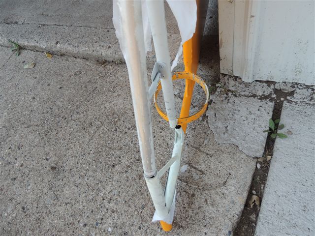

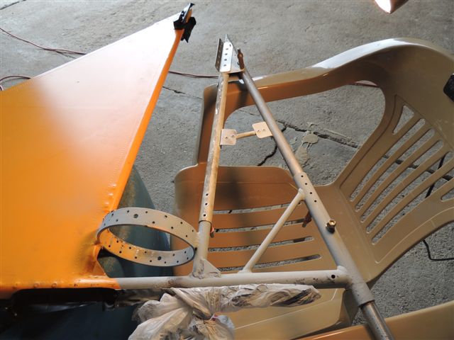

here is a PIC of the tail post supports that I think John Hauck came up with the tail wheel is much better than that Pizza cutter and it does make it handle more like a tail dragger

elleryweld(at)aol.com
PostPosted: Sun Aug 19, 2012 11:22 am    Post subject: Tail Post supports Reply with quote
in your pic you dont have the supports that show in my pic, thicker aluminum tubing will not help the area of failure you had better take another look at my pic the supports I am talking about are attached to the big Ring that slips over the end of the tail boom tube under the elevators attachment points and attach to the bottom tube that your tail wheel rod slides into this will help this vertical Tube from breaking under side load pressure

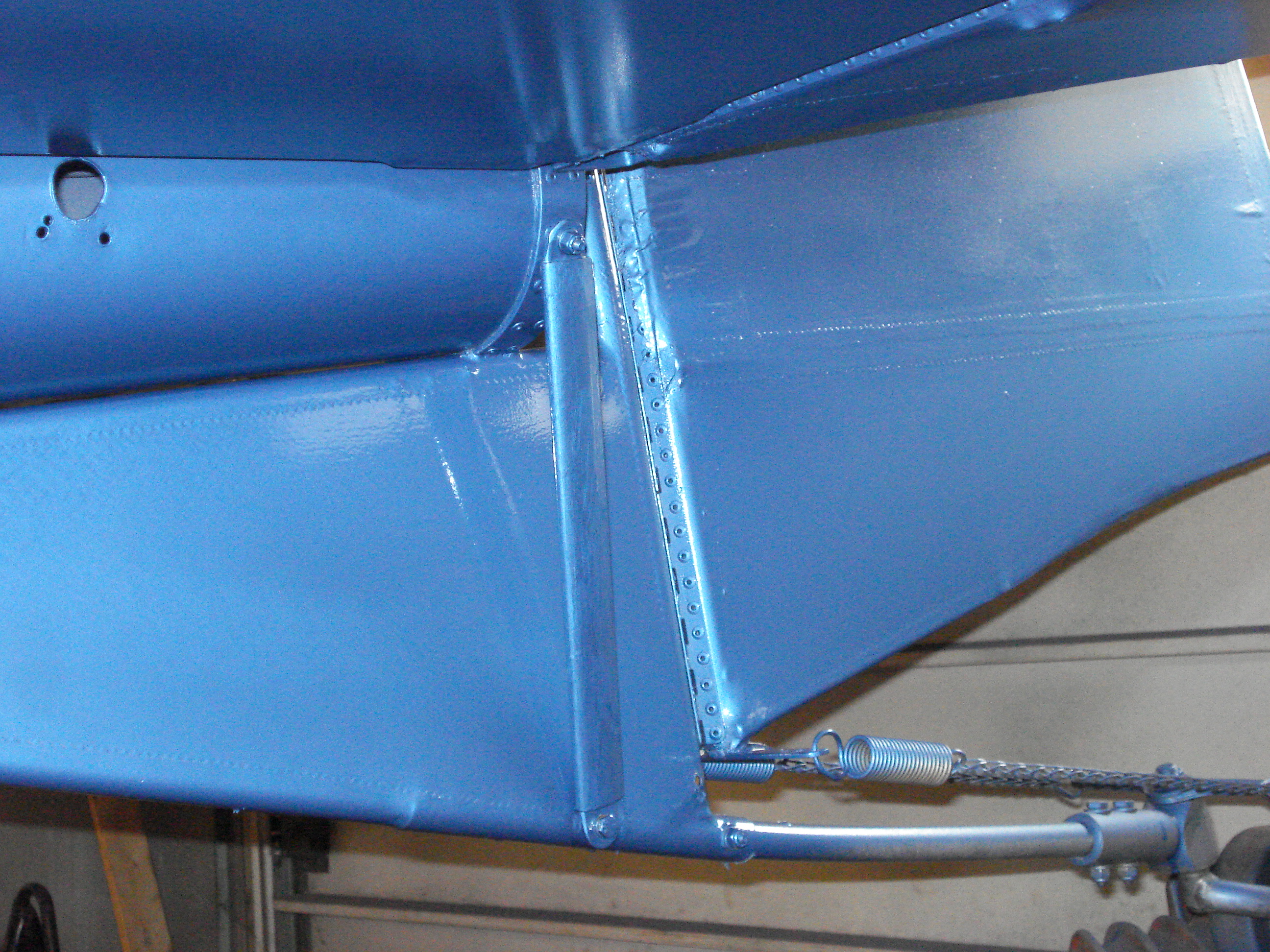

PostPosted: Sun Aug 19, 2012 1:30 pm    Post subject: Re: Tail Post supports Reply with quote
Ellery,
I respectfully disagree. The non-turnable Pizza Cutter tail wheel puts a side torque on the lower tail-fin midway, so when forced into a tight turn, it will break, where as a swivel wheel eliminates this problem.
Take note where mine broke in two places. I don't believe your concept would offer any solution to this, because you are reinforcing it in the wrong location.
Hope this photo helps clarify things.
 Filesize:  78.46 KB
 Viewed:  6726 Time(s)
PostPosted: Sun Aug 19, 2012 6:09 pm    Post subject: Tail Post supports Reply with quote
Thank You Rick I have just repaired my second Tail post on a different kolb in the same place and this is no longer a problem area with the side load supports just my experience but results may differ from other views

PostPosted: Mon Aug 20, 2012 5:38 am    Post subject: Tail Post supports Reply with quote
Rick,
My FS broke the lower aluminum tube flush with the steel just like the picture.I reinforced it using a thicker tube and months later it broke at the steel tube up by the ring as in the photo.If you just push on the top of the tail post you can quickly identify the side loads that affect these tubes even WITH a swivel tail wheel.I am a believer in these braces but It looks like no one but me feels that way about the tail spring clamp.
