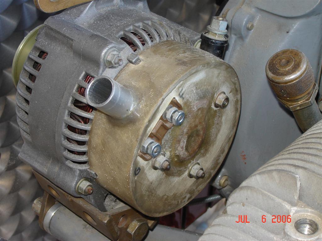

PostPosted: Sat Aug 18, 2012 7:47 am    Post subject: Re: snorkel for alternator cooling Reply with quote
Jurgen,
I've attached a photo of a possible solution. I had the same concerns as you because I have a plenum capturing all the cooling ram air and directing it through the cylinders. My engine installation is battery/electrical system dependent (fuel pumps, EFI & ignition) so I wanted a little insurance for my reversed-fan alternator.
I fabricated the alternator diode plate plenum in the picture from fiberglass and vinyl-ester resin. The resin will withstand 220 deg before going plastic. Epoxy resin systems will also work. Just check to see that the transition temp meets your needs.
You can use the stamped cooling shroud as a mold for your part.
Connect to ram air source with SCAT tube size of your choice. I used 3/4".
Good luck,

The scat tube is light, the time expended in
the grand scheme of things is small. But it
would be really interesting to know if the effort
has any beneficial effect.
The cooling shroud that I built and the scat tube (7") are a few ounces and part of the "mission" of this project has been to have fun.Designing and fabbing this thing qualifies.
Knowing that I was going to build an airplane that was dependent on electrowhizzies to keep air underneath the wheels, I asked an old-school alternator/starter repair shop guy (the kind of place with alternators up to the rafters and huge, antediluvian black machines peppered with large analog meters and cats sleeping on top) for the best way to keep alternators alive and he said to just keep the diode plate(s) cool.
So that is what I did. For both alternators Wink
John
