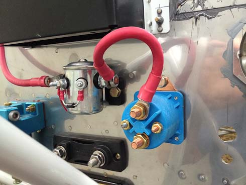

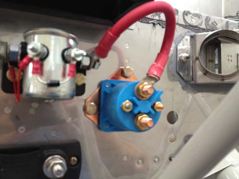

Good Evening Michael,
I think the bend is OK, but I would suggest you try to support it at the apex of the curve to reduce the potential for failure at a fitting.

Hi Folks,
I'm using a short length of battery type cable made by B&C to connect my main contactor to the starter contactor. Both contactors are from B&C. The orientation of the terminal bolts on the contactors does not make for using copper bar easily.
I've enclosed a picture. My question is, do you the think the radius of the bend will put too much stress on this wire? If so, what would you suggest?
