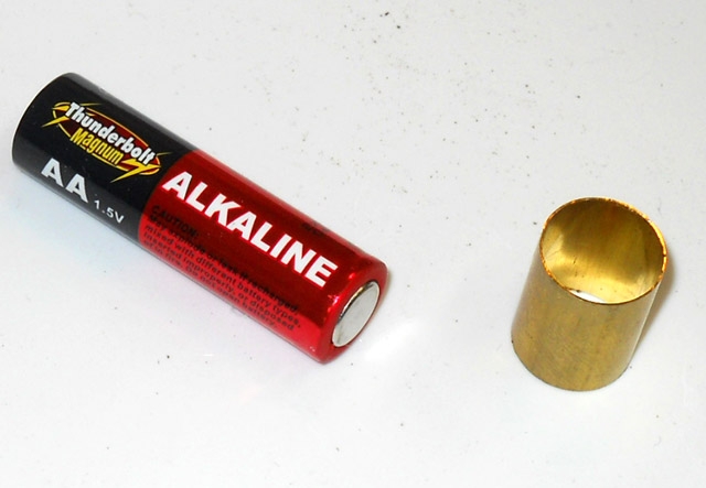

I cut a couple 3/4" pieces of hobby shop brass with a 9/16" i.d. 19/32" o.d.
[img]cid:.0[/img]

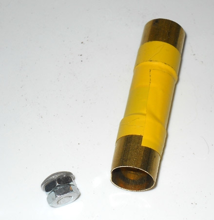

Tape one piece to the (-) end of AA cell so that you have
a recess about 1/8" deep. Tape the other piece to the (+)
end looking for a recess about 1/2" deep. Make a conductive
"plug" to drop into the (+) cavity. Here's a quick-n-dirty
pair of nuts on a 10-32 screw and trimmed flush with a
Dremel.
[img]cid:.1[/img]

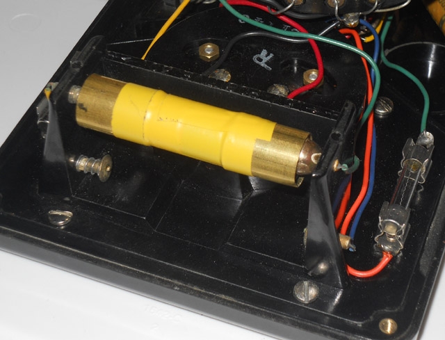

Drop the "plug" into the (+) end and place it between
the cell contacts of the 630
[img]cid:.2[/img]
This configuration captures the cell between the contacts even
though the hv battery is not present.
Also, I'm pleased to report that the single AA cell excites ALL
resistance ranges EXCEPT the highest range. A little time
on the lathe could produce adapters fitted more closely
to the dimensions of the AA cell and the mating contacts
on the 630. A pleasant distraction . . .
