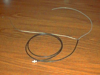

This is actually covered in a March post from Boyd Young, but I need some more particulars if you don't mind.Looks like RG58, but what lengths do I start with before tuning with the SWR meter Boyd?
Thanx G.Aman

For a 1/4 wave antenna in the VHF Airband (118.0-136.0 MHz) about 20" will put you in the middle of the spectrum (127.0 MHz).

i started plenty long.. i think about 25 inches, on both legs, the inner connector, and braid... my ham radio club has an antenna analizer, and i used it to figure the final legnths... i will have to measure the next time i go to the airport.
boyd
