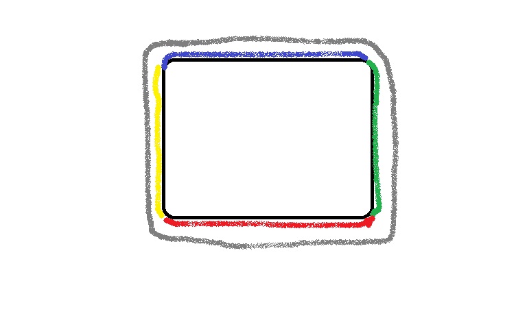

Anyone have pics or video of the glassing process? What I'm trying to figure out is the mechanics of the glass strips. Is each layer cut in one piece to conform to the window's shape or multiple strips that are butted together until the entire gap is covered?

I've attached a crude graphic to illustrate for visual learners like me what I 'm trying to figure out. The window shape is the black rectangle, the colored lines rep individual tapes butted together at the corners and the gray is a single ring of tape cut to the window's shape in lieu of using individual pieces.
Seems like based on the answers so far (and my own very limited fiberglass experience) that the individual tapes are the way to go, but I'm open to suggestions.
