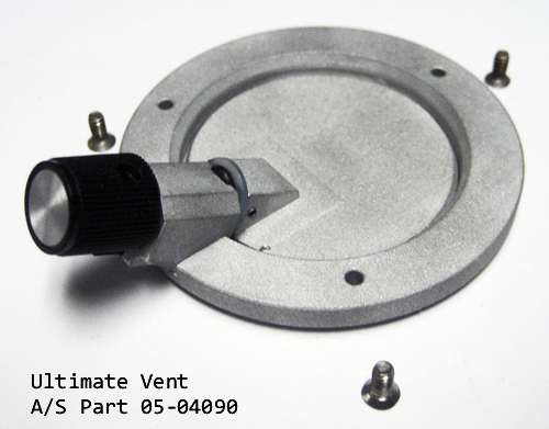

The mod Bruno describes is documented on our web site (http://www.theeuropaclub.org/wp-content/uploads/2011/12/G-MIME-Vents.pdf). It is PFA/LAA approved but at present LAA cannot find the paperwork (or even a number for it).
The ultimate vent is nice (see picture) but expensive.

The ultimate ventilator shown below could be installed easily in your plane. Not sure about your approval to do so and all. I installed them just below the windscreen, above the fuselage jogle, as close to the panel module as possible. They are above my knees and I like the way they are infinitely adjustable. Plenty of air when you want it.
I have seen them installed in the lower corner of the windscreen itself, too

I have cut an inlet each side to allow air in just under the knees. These I have covered by clip on boxes with segmented openings with segmented circular covers which can be rotated to open or close the air path which can enter just under the knees.
However I have not flown the a/c to see how it would work.
