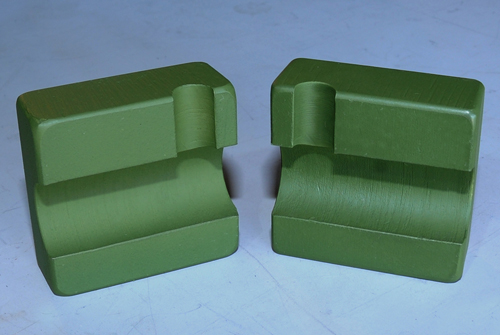

Not everyone's cup-o-tea, but you can make dies like this too. Just cut two
bits of the same steel bar to length, hold them together in a vice, drill a
big hole at the join from the top in one direction and a small hole from the
side. Smooth the end of a rod or pin punch and there you have it, a decent
die you can hold in the vice that will retain the shape of your terminal as
you crimp away the void, prior to solder and heatshrink.
