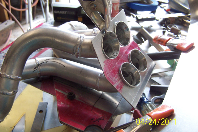

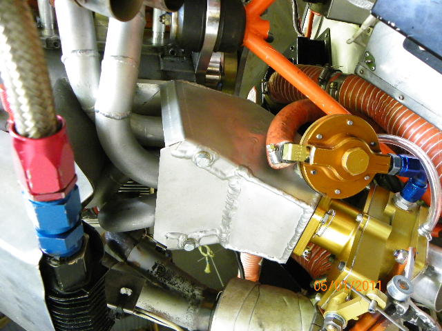

Hi Marvin-
I wish I had taken better pictures, but these two pretty much show
what I did. When I was building it, I was thinking of having the
tubes go through a chamber that would have engine oil pumping through
it, but later decided against that and sawed off some of the "oil
box". In this picture, the box is still partly there. I would have
had to finish enclosing the box...a HUGE job, so I quit thinking
along those lines. The actual intake plenum is the trapezoid-shaped
box immediately in front of (to the left) the TBI. The rest of the
box...like where the bolt heads are showing, was to be the oil box.
This shot shows the basic tubes completed, and I'm just starting to
build the plenum box around the tubes. From looking at these shots, I
can see that I need to take some better pictures of the final product.
through it, but later decided against that and sawed off some of
the "oil box". In this picture, the box is still partly there. I
would have had to finish enclosing the box...a HUGE job, so I quit
thinking along those lines. The actual intake plenum is the
trapezoid-shaped box immediately in front of (to the left) the TBI.
The rest of the box...like where the bolt heads are showing, was to
be the oil box.
<100_1055.jpg>
<100_4853.jpg>
build the plenum box around the tubes. >From looking at these
shots, I can see that I need to take some better pictures of the
final product.

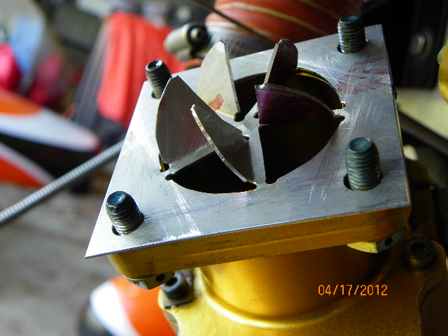

A couple of other possible reasons for the successful Gami lean test
could be the "swirling device" that I built in April, and the exhaust
system that I built/installed in June. I built the swirler and
installed it, but it didn't seem to do a lot for the EGT spread that
I was seeing. I built 5 blades into the swirler, thinking that if I
wanted to change something, I could just rotate the device one bolt
hole either way and the 5 blades would change their orientation
relative to the intake runner tubes. I have never touched it since I
installed it. This was also about the time that I began to disregard
the one cylinder that was always about 80-100 deg. F. cooler than the
rest, EGT-wise. Since that cylinder was always looking good plug-
reading-wise and exhaust pipe color-wise, I just quit chasing that
"rogue" and lived with the off-reading.

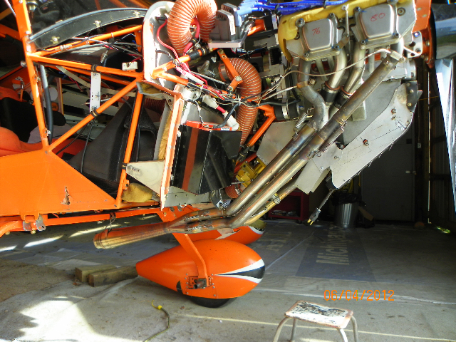

Then in June, I bought a 4-into-1 collector and megaphone, tuned to
the specifications of the Jabiru engine. I had to build the pipes
leading to the collector. (The rear pipes on both sides are a few
inches shorter than the front pipes for now, but I plan to correct
that in the near future, further equalizing the breathing of each
cylinder.)
So with the swirler atomizing the incoming charge, and the "almost
tuned" exhaust system helping to scavenge the exhaust gasses....and
thus helping bring in the fresh air/fuel mixture...I feel both of
these features help make the engine breath easier and more equally
between cylinders.

PostPosted: Thu Aug 23, 2012 6:51 am    Post subject: Newest GAMI lean test...probably off-topic for most Reply with quote
Good Morning Lynn,
Both items look elegant to me!
Any idea how much those tail pipes weigh?
Happy Skies,
Old Bob

PostPosted: Thu Aug 23, 2012 8:05 am    Post subject: Newest GAMI lean test...probably off-topic for most Reply with quote
Hi Bob-
I didn't happen to weigh the whole thing, but the 4 bends (1.31 lbs.
ea.) that I got...16 ga.....came to about 5.24 lbs, but I didn't use
all the length, so call that 5 lbs. The collector and megaphone (18
ga.) I'm guessing came to about 5-6 lbs, so maybe 11 lbs total. I'll
weigh it when I go to the hangar later today, as I need to take the
collector and megaphone off soon anyway, so I can polish the
stainless steel again....one of the drawbacks to having an exposed
exhaust system. : )

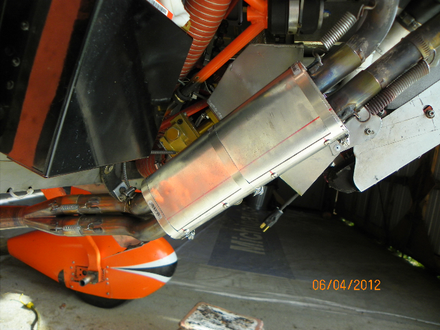

By the way, here's a shot of one of the two heat muffs that I
built...so there's an additional 3-4 lbs per side. Geez, it may be
heavier than I thought...horsepower cost money, they say.

PostPosted: Thu Aug 23, 2012 8:25 am    Post subject: Newest GAMI lean test...probably off-topic for most Reply with quote
Hi Lynn.
I am sure it is lighter than a turbo and undoubtedly a lot more efficient!
Being able to run lean of peak saves weight on fuel required. Ya just gotta make long enough flights to take advantage of the efficiency. <G>
I love it!
Happy Skies,
Old Bob
Lynn Matteson
Jabiru 2200, #2062
Prince prop 64 x 30, P-tip
Rotec TBI-40 injection (sleeved to 36mm)
Status: flying with 1336 hrs... (since 3-27-2006)
On Aug 23, 2012, at 10:50 AM, BobsV35B(at)aol.com wrote:
Good Morning Lynn,
Happy Skies,
Old Bob
 Filesize:  401.09 KB
 Viewed:  20773 Time(s)
marvinlnaz(at)yahoo.com

Hi Marvin-
I wish I had taken better pictures, but these two pretty much show what I did. When I was building it, I was thinking of having the tubes go through a chamber that would have engine oil pumping through it, but later decided against that and sawed off some of the "oil box". In this picture, the box is still partly there. I would have had to finish enclosing the box...a HUGE job, so I quit thinking along those lines. The actual intake plenum is the trapezoid-shaped box immediately in front of (to the left) the TBI. The rest of the box...like where the bolt heads are showing, was to be the oil box.
<100_1055.jpg>
<100_4853.jpg>
This shot shows the basic tubes completed, and I'm just starting to build the plenum box around the tubes. >From looking at these shots, I can see that I need to take some better pictures of the final product.
As far as the Gami lean test is concerned, you start with a rich mixture, and then start to lean the engine in small increments, according to the fuel flow meter, watching the EGT readouts. The temperatures will rise as the engine is leaned, and then you will see the EGT's reach a peak temperature, and further leaning will cause the temperatures to start to drop. Normally this "peak and drop" will happen one cylinder at a time, over the course of leaning in very small increments....in my case I was leaning by 0.1 gph according to the flow meter. When I did this test back in 2009 right after I installed the TBI, (and using the original Jabiru manifold) the rear two cylinders peaked first, then one of the fronts, and finally the last one peaked. This was over the course of leaning that covered a 0.3 gph range. On a small engine like the Jabiru 4-cylinder, that shows that the fuel distribution in the intake manifold is not real good, but not terrible, either. But with the current manifold that I built, the EGT's will peak, and the next 0.1 gph reduction in flow (leaning), causes them all to start dropping right now. This shows excellent fuel distribution according to the Gami method of lean testing. The writings of people that I have read...John Deakin, Mike Busch, to name a couple...say that most carbureted engines don't have very good fuel distribution, so I'm pretty tickled with my results.
The address for the lean test is: http://www.gami.com/gamijectors/leantest.php
Some interesting reading about engine operation is found in John Deakin's writings. Here is the address for a complete index of his articles, Pelican's Perch:
http://www.avweb.com/news/pelican/182146-1.html

I didn't have the gumption to polish the collector and meg, but I DID
take it off and weigh it....2 pounds....and they are both 18 ga.
The Jab muffler...and 6" of extra tail pipe on each exit
pipe....weighed 5 pounds. So probably 4 pounds for the original
muffler as it came from the factory.
All in all, the whole new exhaust system and heat muffs probably
weighs 11 pounds. I was way off on my original guess of the collector
and meg, so I was also probably off on the heat muffs, too....getting
old is a bitch!

Lynn Matteson
Jabiru 2200, #2062
On Aug 23, 2012, at 12:33 PM, Marvin Williams wrote:
Thanks for the photos Lynn! Nice job!
I also modified my air passage into my TBI, but not nearly like
yours. I merely bent the top (horizontal) blades of an air
straightener I bought from AS downward so as to direct more of the
intake air accross the TBI spray bar. It changed the EGT spread,
but can't say that it made it significantly better. i.e., changed
which cylinder was the hottest. I believe that were I to take
enough time to make numerous changes in the air intake to the TBI
that I could get my EGTs (thus fuel flow spread) much closer than
they are now. Maybe what I should do is just build a 'swirler' like
yours and forget the store bought 'straightener'.
As you well know, just changing the power setting changes EGT spread.
Thanks again for the photos.
Marvin

PostPosted: Thu Aug 23, 2012 10:08 am    Post subject: Newest GAMI lean test...probably off-topic for most Reply with quote
Just a quick question Lynn. Do you swirl the TBI input or output air? I'm guessing output.
Marvin
Sent from my "Geeky" iPhone
On Aug 23, 2012, at 10:48 AM, Lynn Matteson <lynnmatt(at)jps.net> wrote:
Thanks, Marvin.
Yes, changing the rpm will change the EGT readings all over the place....the spread AND the location of the hottest cylinder. And with a 3300, I'd guess it's even worse.

Lynn Matteson
Posts: 2778
PostPosted: Fri Aug 24, 2012 2:14 am    Post subject: Newest GAMI lean test...probably off-topic for most Reply with quote
Yup, output...I wanted to mix the air and fuel as much as possible.

BARRY CHECK 6
Joined: 15 Mar 2011
Posts: 738
PostPosted: Fri Aug 24, 2012 2:33 am    Post subject: Newest GAMI lean test...probably off-topic for most Reply with quote
Lynn:
Which way is the swirl pattern in the carb throat, clockwise or counter clockwise?
And how did you determine it?
Barry
