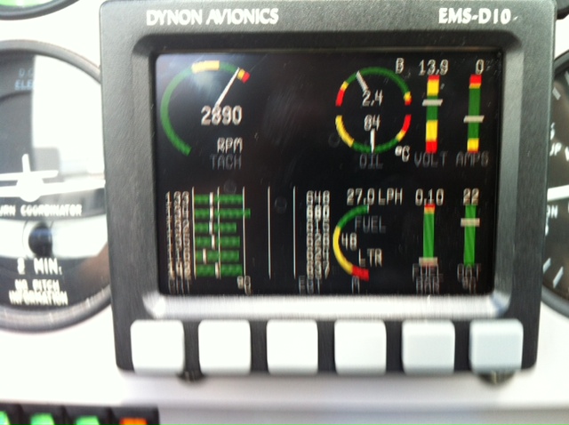

I am enjoying reading this discussion.... We are going through the same ourselves. Here is my dynon screen of progress so far, this is in steady cruise. I am wondering if fuel burn is a bit too high still. We have just reduced damming on cylinder 6 so hopefully it will come down a bit. Egt still very uneven.
