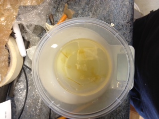

wonder if anyone could answer my quick question regarding the ampreg 21 hardener?
I have just received a new batch of resin and standard hardener from Europa. when I mixed a batch this afternoon it appears to me that the hardener has had a skin formed on it or it has a contaminant in it as there appear to be long strands of something within the hardener that pours out when mixing the resin and hardener.
Can anyone advise if this is normal as when doing a trial layup these strands can be seen within the lay ups.
I have attached a photo showing the strands just after pouring into the resin.
I look forward to hearing your thoughts on this.
Kind regards
Donald

HI Donald,
The laquer coating has come away from the inside of
the tin and causes the orange blobs.
They told me to filter it out which I did but was not prepaired to use it anyway.
Give Tony a ring at Marineware on 02380 330208, they will replace it FOC As they did with mine,
Steve, # No.630

Hi Steve
Many thanks for your reply its much appreciated.
Im awaiting a reply from Europa as i purchased it through them they are meant to be phoning me back tomorrow.
If i don't have any joy i will contact tony at marineware to see what they say.
Kind regards
Donald

Hi Donald,
so did I, Europa refered me to to the
manufacturer and they refered me
to Marineware,
Steve. #630

Hi steve
Thanks for that information in that case I will contact marineware tomorrow.
Many thanks for your help
Kind regards
Donald
