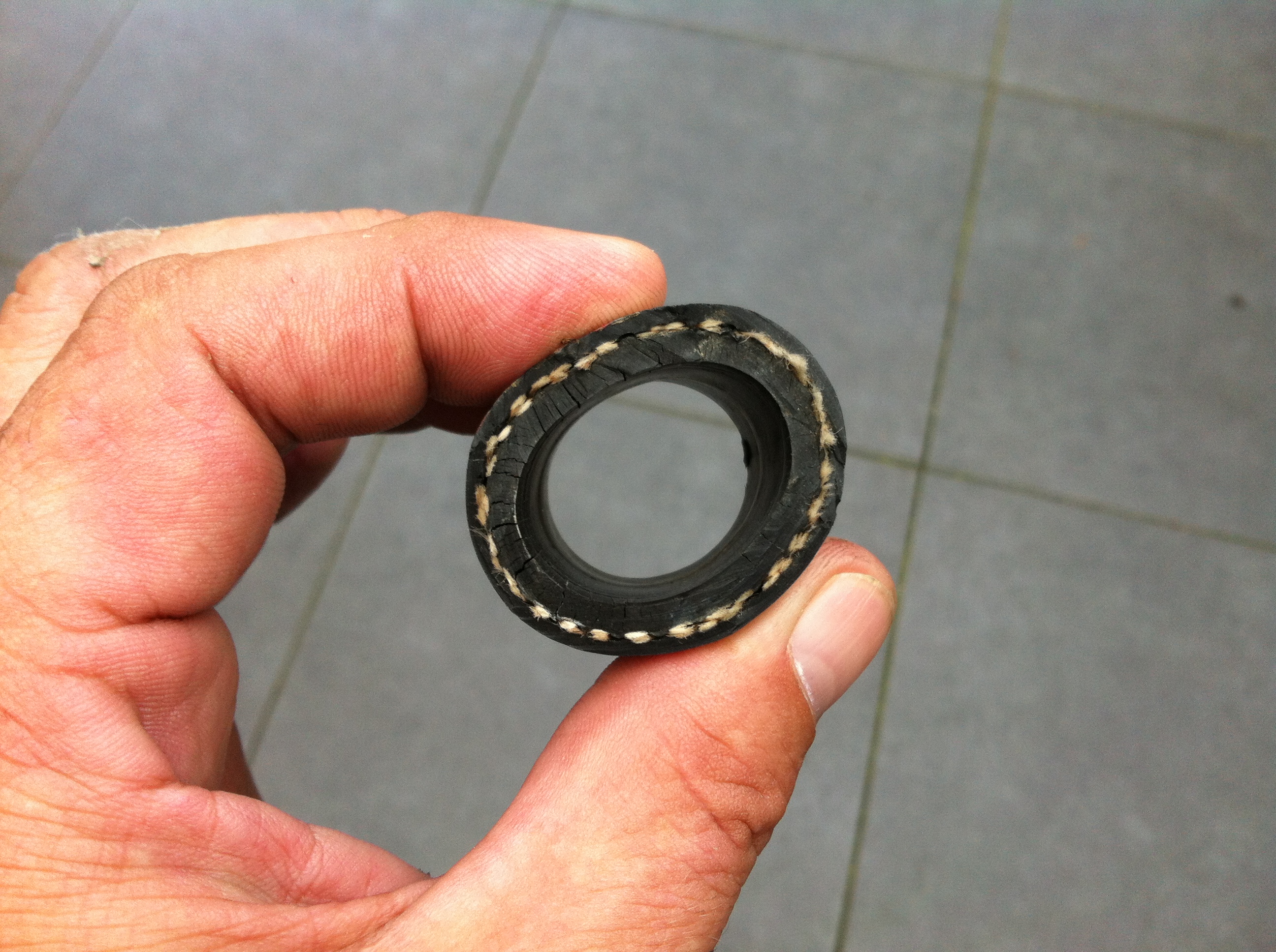

Today I did a more in-depth examination, and it turned out that (instead of the rubber joining the tank and aluminium elbow of the filler) the rubber joint between fuel-return line/tank breather and the tank was the one leaking.
After taking that rubber off, I noticed that a substantial piece of the inner-lining was showing severe cracks (see attached image). No wonder the smell of fuel had increased lately, and it started to leak...
Hopefully the smell fuel will be gone (or substantially decreased) now I have a new rubber joint in place...
A valuable lesson learnt: make sure rubber hoses are in tip-top shape, if in doubt, replace them! I will still have to replace the rubber joint between tank and aluminium elbow of the filler, if only because I am not 100% sure of the condition of it's inner lining and I don't have records of when this was replaced last...
Cracks in inner-lining clearly visible
