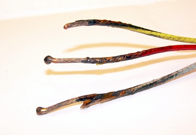

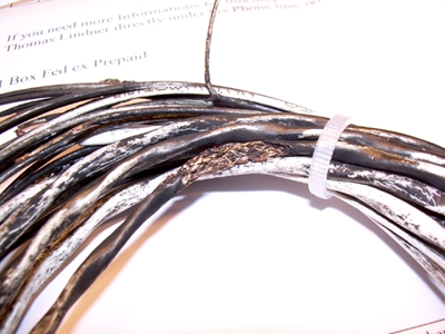

I dug around in the archives and found some
of my data and reports generated therefrom for
the Hawker incidents cited.
[img]cid:.0[/img]
[img]cid:.1[/img]
Note that damage to these bundles ORIGINATED with
a single, small fault to ground. A contaminated
crack or more probably, rubbed through by motion
against the airframe. Note that this insulation
is a tape WRAPPED around the wires and fused
. . . not extruded as a contiguous amorphous
sheath.

airplanes is a new breaker (VERY expensive) that
can detect both hard faults (shorts and overloads)
and soft faults (arcing). Swissair 111 would probably
not have suffered its fate had the faulted wire
bundles not been routed adjacent to flammable
insulation.
Does anyone have flammable insulation in their
RV?
One cannot know the thinking behind selection
of this wire 30+ years ago. The military and
commercial aviation communities were wrestling
with some perceived shortfalls in the insulation
of choice for the era and the new kids on the
block . . . Teflon and cousins showed a lot of
promise.
Some folks made some terrible, expensive choices.
Don't know how many accidents were caused but
I do know of entire fleets of military aircraft
that were totally re-wired after carrier
based versions contracted dandruff of the
wire bundle and started shedding insulation
in little flakes.
I was working with the Gates-Piaggio GP-180 at
the time Lear was looking hard at Tefzel. An
export controlled product with strong military
implications. I was ready to go with RayChem's
Spec 55 wire with very nearly the same properties
of Tefzel and not export controlled . . . but
about 10-15% more expensive.
We ultimately acquired the export license and
the GP-180 was wired in Tefzel . . . and probably
still is. If it's not wired in Tefzel, then the
machine has probably fallen victim to knee-jerk
reactions so common to bombardment by Chicken
Little worriers without regard to assessment of
real risk.
Too many designers, regulators and decision makers for
modern products are NOT cognizant of history nor are
they capable of accurate consideration for magnitude
of risk. Their charter is to drive all risks to zero
no matter how much it costs.
Instead they float with the tide of regulations and
recommendations that flow from a constellation of
agencies who are paid to worry . . . and worry
they do. Present trends plotted into the future
suggest that risks associated with all forms of
transportation will be driven to ZERO. It's easy.
Regulate those systems out of existence with
constrictions of critical components like fuel,
unattainable efficiency mandates, traffic flow
boondoggles and yes . . . insulation on wires.
 Filesize:  84.54 KB
 Viewed:  11629 Time(s)
 Filesize:  61.02 KB
