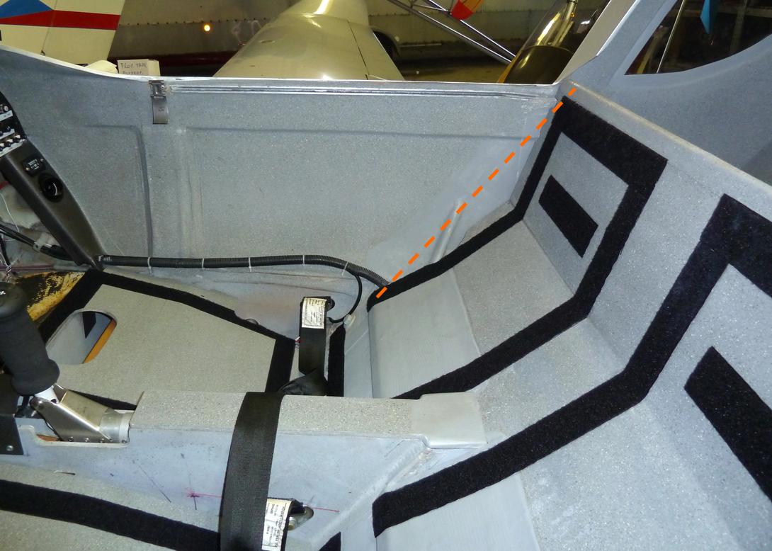

I am 6ft 2" tall and I have done the following mod. to fit in. I have cut the original back rest and shaped it in "S" form to follow the spine curve and used for the seat cushion 1" thick Confor foam medium blue. I find it very comfortable without taking too much of the headroom.
On the picture the red dotted line represents the original shape. The black stripes are velcro stuck on with cyanoacrylate glue to keep cushions in place.
otto

This is more of a structural change, but you would gain some  head room by moving the top of the seat back thereby increasing the angle at which one is reclining .
