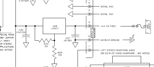

Radios and audio systems need really clean power
and the qualified designer provides smoothing
internally.
[img]cid:.0[/img]
Our audio isolation amplifier design uses the LM317
to provide a smooth source of +8 volts to run the
circuitry.

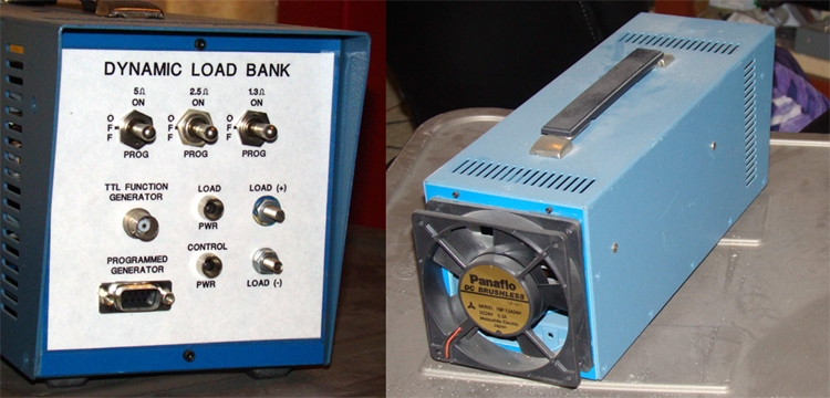

Tell me more about your dynamic load bank. Sounds like just the ticket.
Here's one I started for my shop some years ago but
when the project-of-need went away, it's been waiting
for a reason to finish it.
The one I built for HBC might still be there but
since it never got a corporate acquisition sticker
or tool number put on it, it's probably been pitched
by now. There's nobody left there who saw what it does
or how to use it.
[img]cid:7.1.0.9.0.20120803101747.0479aac8(at)aeroelectric.com.2[/img]
The thing was used to study the effects of rapid
load dump and onset for some led lighting supplies
in the Hawker 800. When the cabin lights 'flicker'
in a $14M airplane, the boss can only sit there an
fume that this crap doesn't happen in his $60K
automobile.
The notion was to excite the bus with repetitive
square-wave loads either manually by external
controls while gathering responses and/or trying
fixes elsewhere.

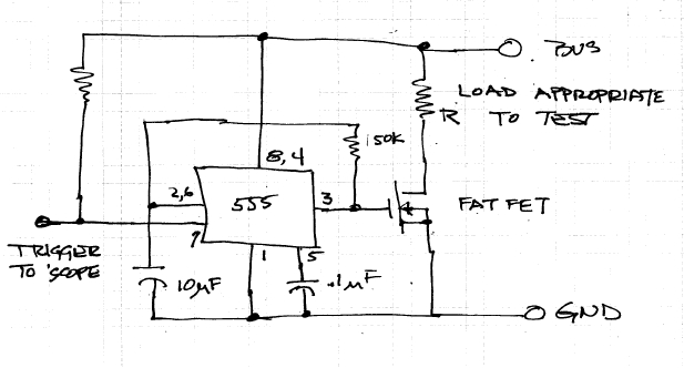

For our purposes, a 555 timer, a boss-hog fet
and a power resistor could be quickly brass-boarded
into a similarly useful fixture.
[img]cid:7.1.0.9.0.20120803101747.0479aac8(at)aeroelectric.com.3[/img]
This test fixture would apply/release a load
at some periodic rate (in this case about 0.5Hz)
to let you observe system response after
the event.
Your Dataq DAS in the single channel, fast
acquisition mode would do nicely to record
the event.
