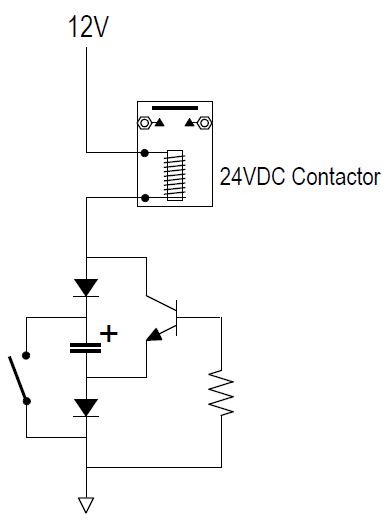

Has anyone considered this voltage doubling circuit ? It was the Circuit Cellar EQ question in Issue 248 March 2011.
The theory behind the circuit is that while the contactor is off, the capacitor charges to 12V. When the switch is turned on, the positive of the capacitor is 0V, so the negative side becomes -12V. The transistor now conducts, applying 12+12=24V across the contactor coil, closing it. The capacitor quickly discharges and the transistor switches off, leaving 12V across the contactor coil. 12V is probably enough to keep the contactor closed and at half the current of a 12V contactor.
Once the flight has begun, the failure mode is down to the contactor, the switch and one diode, which is the same component count as the standard circuit (The spike shunt diode is not required for this circuit, since the current from the coil serves to charge the capacitor faster).
The article did not propose values for the components, so it is quite possible that the capacitor would need to be impractically large.

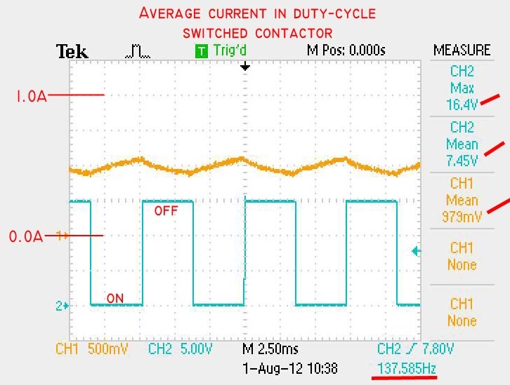

I recommend that the power saving duty cycle
be set for not less than 50%. This cuts average
voltage to contactor by 50% . . . hence average
current by 50% and total power dissipated by
75%.
While a 12v contactor will stay energized at
voltages of 2v or below, you want to make sure
that the contactor stays closed down to battery
end of life at 10.5 volts or so. 50% at 14 volts
with alternator running gives you 7 volts to hold
the contactor . . . 10.5 translates to 5.25 volts
or thereabouts . . . probably as low as you want
to go. 75% reduction in lost energy is pretty
substantial if you're in a battery-only operational
mode . . . or struggling to make the most of an
8A alternator.

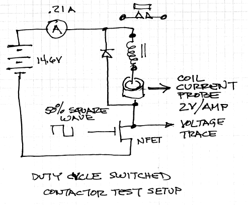

Is that 75% power reduction correct??
I would have guessed that a 50% duty cycle gave full voltage and full
current for 50% of the time in a pulsed resistance circuit resulting in
a 50% power reduction. Not sure about an inductive coil contactor though.
Just asking but intuitively I would not have averaged the voltage and
applied the I squared power calculation to this.
Ken

When to the bench and set this up:
[img]cid:.0[/img]
This test setup produced the following data:
[img]cid:.1[/img]
If I go to 100% duty cycle, this El Cheeso,
Stancore/RBM contactor draws 0.9 amps 14.6 volts.
Dynamically, the coil current (Yellow trace) shows
some ripple at the switching frequency but averages
just under 0.5 Amp.
In the mean time, the power supply is showing a
load of just 0.21 amps or about 25% of the full-on
current draw.
If I put a 15 ohm resistor in place of the\
contactor, the 100% current goes to the expected
1 amp. At 50% duty cycle, the peak current is still
1 amp with average current falling to the predicted
0.5A . . . hence 50% duty cycle produces only 50%
reduction in power in the resistive circuit.
The L/R time constant of the inductive circuit
prevents achievement of full current during limited
on-time. The diode prevents current from falling
to zero during off-time.
After one hour, the outside temperature of the
contactor was not too hot to sustained touch . . .
Waayyy cooler than contactor operatied at 100%.
