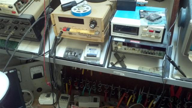

Do you have access to a fast data acquisition
system that you could hook to your bus for
some hard data gathering?
I've used cousins to this critter . . .
http://tinyurl.com/3jtrxx4
on several tasks at HBC with great results.
Being able to jump on an airplane and get
hard data in flight without having to involve
a dozen folks from the instrumentation lab
was a powerful tool.
You might consider getting one of these
and use it to graph some of the performance
qualities of your system. It would be a great
augmentation of my ripple studies.
[img]cid:229104122(at)02082012-1957[/img] I have a couple of these first generation DI-148Us.
It will run at 11 KHz sampling rate on one channel.
Tell me more about your dynamic load bank. Sounds like just the ticket.
I'd be happy to contribute!
I'm probably a month away from first start and another month coming down off the high!!, -john-
