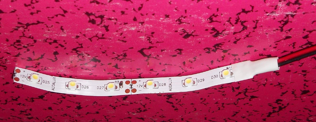

I have been experimenting with a product available
off eBay that offers 300, .05 x .05 LED's mounted
to a 3/8" wide x 16 foot flexible etched circuit
strip.
http://tinyurl.com/c33w25o
The leds are wired in paralleled series-clusters of
3 devices and a 150 ohm resistor. Here's a 2-cluster
segment of this product . . .
[img]cid:.0[/img]
You can cut the strip every three devices and attach new
power leads at the solder pads visible in the photo.
I'm going to be using about 80 feet of this product in
my kitchen to put double rows of ceiling accent lighting high up,
double rows to replace recessed canister lights over the
counters and a third twin-row installation under the cabinets
for work lighting. The double-rows will be wired in series to run
off 24 volt supplies in the walls. My present lighting
is fraught with hot-spots from 11 different fixtures with
no accent lighting on a budget of about 700 watts. The working
end of my kitchen will be nicely lighted for both appearance
and working illumination on a power budget of about 175
watts total. This technique produces very wide-angle
illumination that is virtually shadow free.

[quote] I have been experimenting with a product available
strip.
<1839fa0.jpg>
The strips are fitted with peel and stick adhesive. I'm
going to use 3/4" wide strips of Formica to assemble one-
piece lighting assemblies that make it easy to get the
rows installed straight while laying on my back under
a cabinet.
The light output from these devices is very good. I suspect
that one could put a single strip of this product on the
under side of a glare shield and get more than enough
light . . . with devices easily dimmed. Due to the
series wiring of three, 3-volt devices, you would want
to control dimming with a series resistance or an
adjustable current supply like a Buck-Puck. Ten of
these clusters would give you about 30 leds and a max
bright current draw of 300 mA. A constant voltage
dimmer like B&C sells COULD be modified to have minimum
brightness occur at 9 volts instead of the present
4 volts. In any case, This product offers a host of
illumination opportunities not the least of which is
your airplane.
