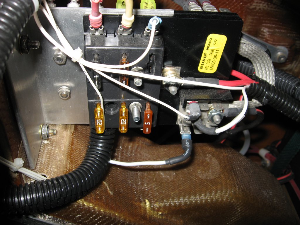

Jeff,
I also fly an Long-EZ, also with an automotive alternator and ATC fuses. I mounted two fuse blocks back-to-back to a bulkhead and just above the nosewheel cover. Attached is a picture of the battery-bus side of the fuseblocks. (Note: some of the fuses visible are just spares.) The fuses are accessible through the nose access hatch.
My alternator is an internally-regulated Hitachi (from a 1979 Datsun pickup) and suffers no ill effects when I disconnect it from the bus with a contactor. $50 at rockauto.com!
Email me if I can help you with any electrical or wiring issues.
