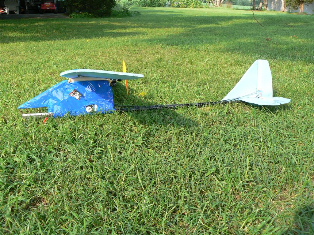

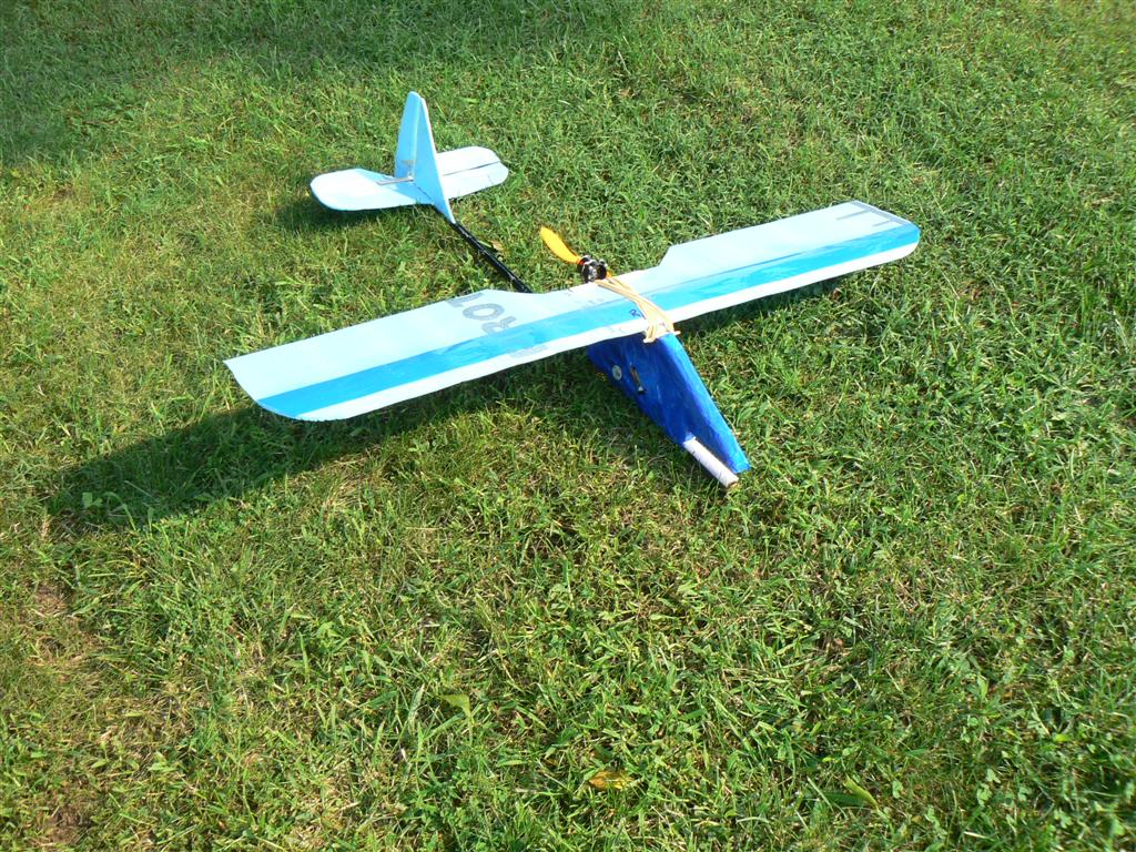

Ok, here ya go. First of all, the Flying Ninja Monkey. Grandma didn't get a picture of her with the xmtr, this was earlier today working on a tie-dye shirt. (Gotta keep up the hippie traditions, ya know)
The rest are of the so-called FSII. Bear in mind that the primary concerns are indestructability and ease of repair, and not fidelity to scale appearance. Or any other kind of appearance, which is good, this thing has already been knocked out of a tree twice when it got stuck about 30 feet up. Duct taping one bamboo pole to another and then using the extreme end to poke and flail at the model while standing on a 6' step ladder does nothing to improve the cosmetics... Not to mention being flown full-bore into the sod a couple times -
Have used, abused and broken this thing many times. Recently covered the fuselage with superthin light blue tape I got a few years ago, it is lighter than paint. It doesn't help it much -

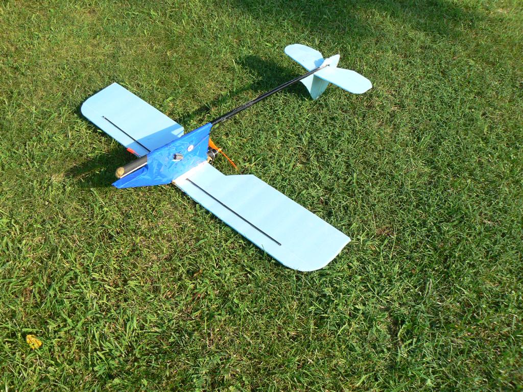

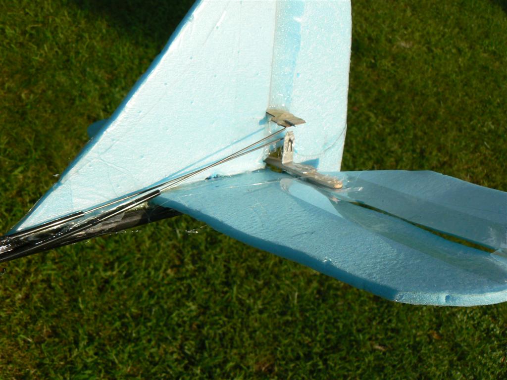

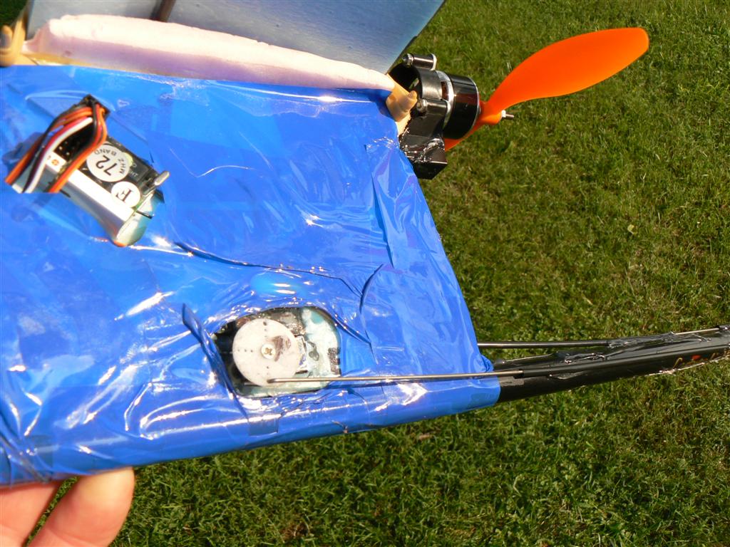

This ersatz FSII's primary virtue is that it is extremely easy to fly, very stable, and easily repaired. You can replace the wing and the whole tail in about 45 minutes. The fuselage part is virtually indestructible. The fuselage tube is an old carbon fiber golf club. The fuselage section is 5/8" insulating foam. The wing and tail is fan-fold foam, several years ago I bought two full bundles of it, and have used it to make all sorts of easy to build and dirt cheap models. Everything is held together with low temp hot glue from the craft section of the big box store.
I suppose that with a little attention to detail you could easily make this look a lot like a real Firestar, (it looks pretty good from about 75' away except for no L/G) but that would be wasted on this beater. OTOH, it is perfect for a 7 year old girl.

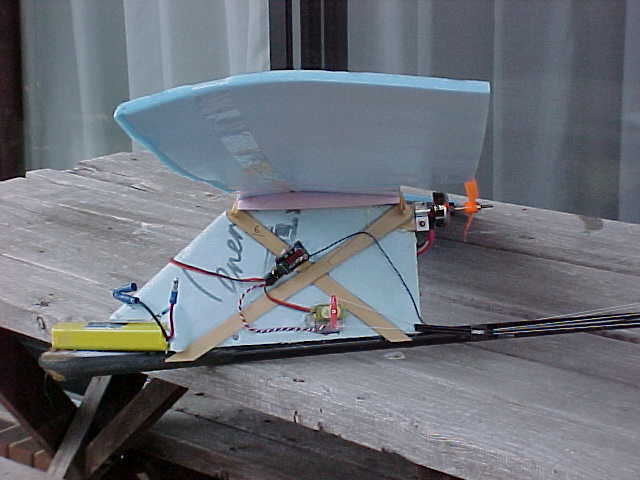

Popsicle stick elevator connector. 1/32" plywood horns. Coffee stirrer push rod guides.

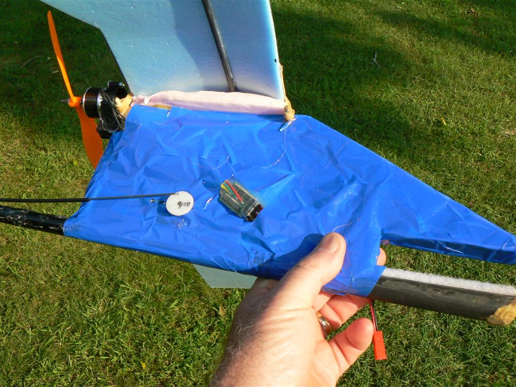

Receiver & servo. Wire push rod & coffee stirrer guides

Clay for W&B. Velcro to hold the battery

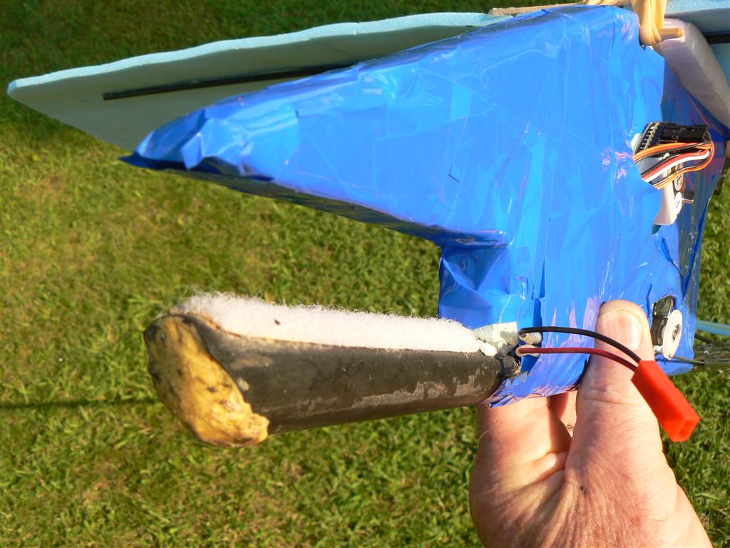

Carbon fiber tube hot glued in place under the wing

Glue a pop sicle stick to the top of the foam to resist the rubber bands.
