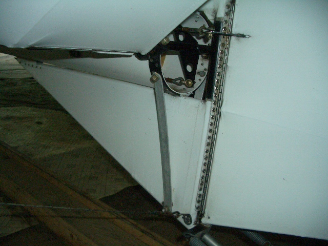

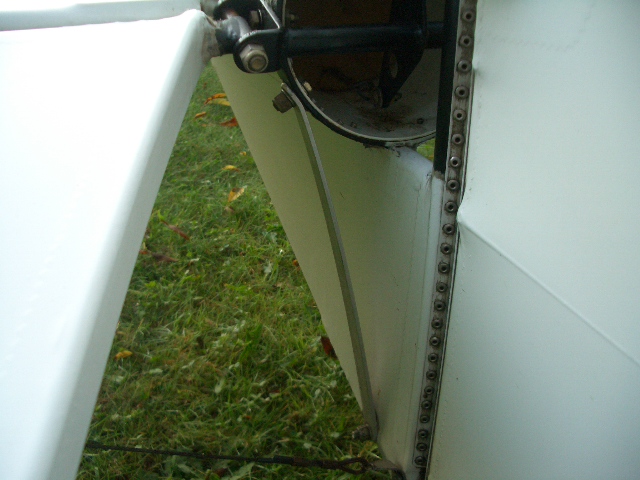

Frank , I would recommend installing the tail post brackets on all Kolbs I just repaired one on a MK3C
Ellery Batchelder Jr.

" I would recommend installing the tail post brackets on all Kolbs "
Ellery Batchelder Jr. "
Can you show a picture of these tail post brackets ?

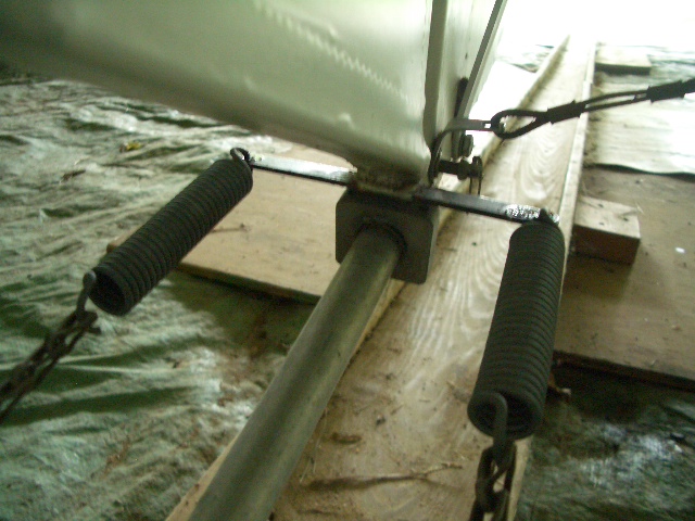

 Filesize:  34.58 KB
 Viewed:  8594 Time(s)

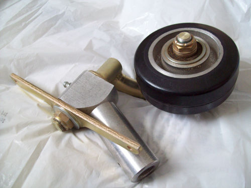

zeprep251(at)aol.com
PostPosted: Sat Aug 18, 2012 3:59 pm    Post subject: A swivel tailwheel question Reply with quote
[img]cid:tie_8CF4BB4449CE2D4_13AC_8E781[/img]
 Filesize:  171.33 KB
 Viewed:  8585 Time(s)
 Filesize:  170.46 KB
 Filesize:  173.99 KB
dpeters160(at)gmail.com
PostPosted: Sat Aug 18, 2012 4:16 pm    Post subject: A swivel tailwheel question Reply with quote
Could you provide the part number of the Marco tailwheel assembly pictured; I don't seem to be able to find the same on the internet. Thank you. On Aug 18, 2012 5:03 PM, "Gary Aman" <zeprep251(at)aol.com (zeprep251(at)aol.com)> wrote:[quote] [img]cid:tie_8CF4BB4449CE2D4_13AC_8E781[/img]
