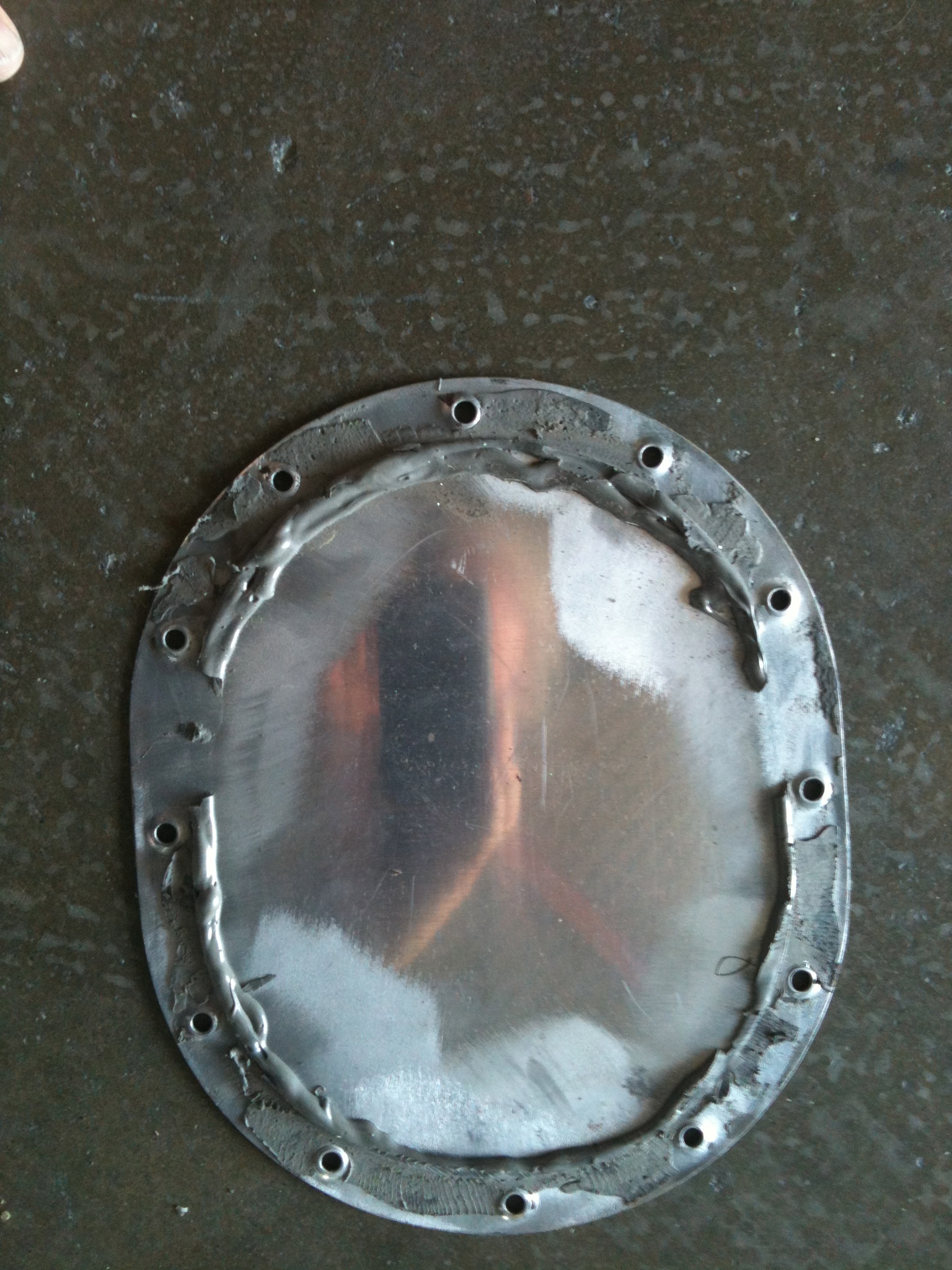

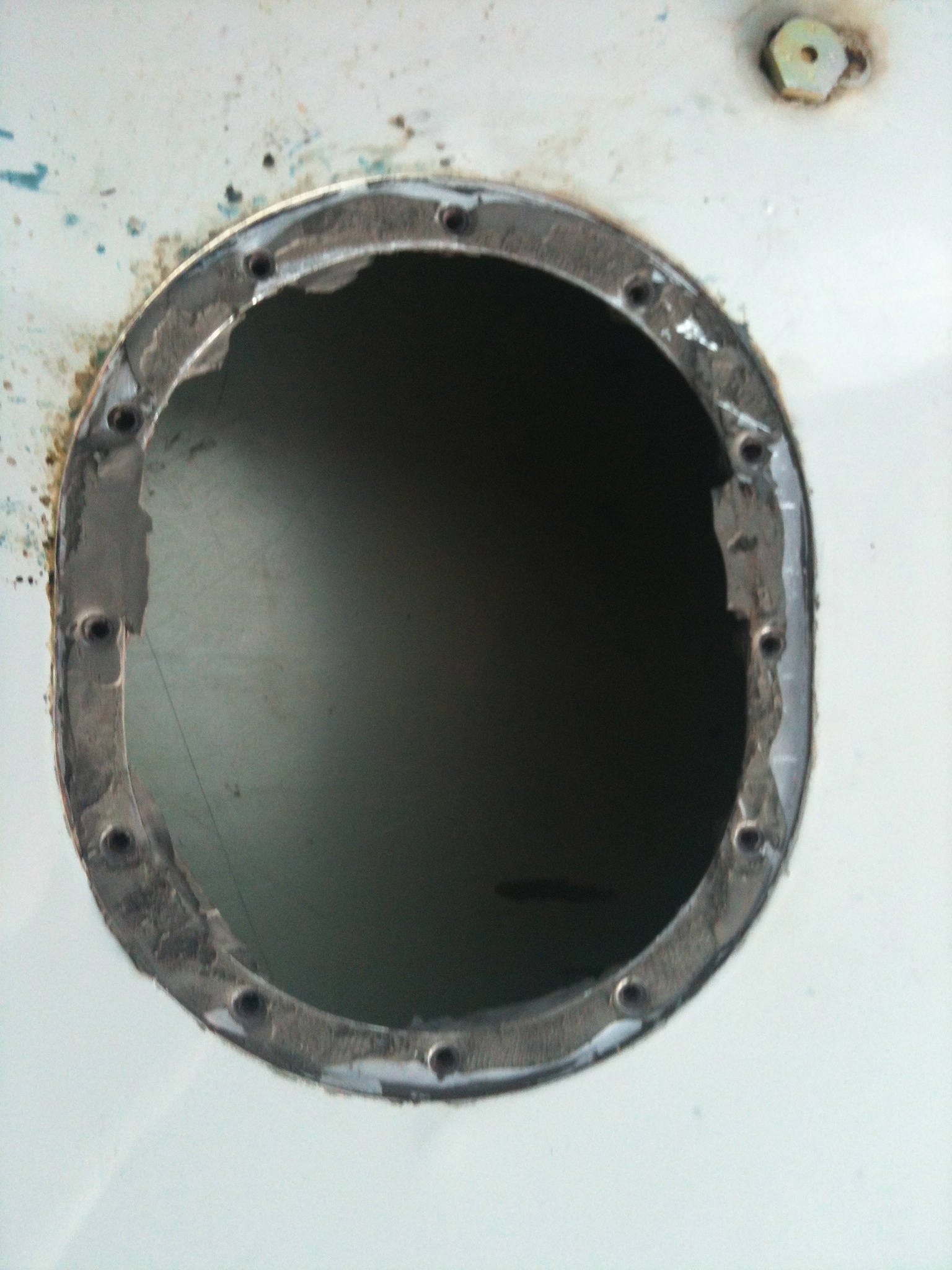

So, 5 years ago this month, I resealed both wing tanks and all access covers on this guys Tiger.  Apparently the local guy at the Columbia, CA airport didn't have resealing experience. The reseal and annual took 6 months. There was a LOT of stuff wrong. Most notable was the spinner with 1/4 inch runout. The rear backing plate was that far off.
So, I get a call last week and the owner wants me to reseal the access covers. I don't know about you, I don't normally inspect inside the fuel tank at annual. For some reason, ALL of the access covers had been off since I resealed them 5 years ago.
Here is a shot of one access cover that leaked so bad it wouldn't hold fuel. The owner said the mechanic he used had tried three times to seal it.

haveblue1(at)mac.com
PostPosted: Wed Jul 18, 2012 1:37 pm    Post subject: leaking access cover Reply with quote
Gary,
Bottom photo, at about the 9:30 position. Is that an errant screw hole or a glob of sealant?

bob.hodo(at)yahoo.com
PostPosted: Wed Jul 18, 2012 3:21 pm    Post subject: leaking access cover Reply with quote
Shouldn't that sealant be a dark purple?

teamgrumman(at)yahoo.com
PostPosted: Thu Jul 19, 2012 10:55 am    Post subject: leaking access cover Reply with quote
"Is that an errant screw hole or a glob of sealant?"
glob of sealant.
PostPosted: Thu Jul 19, 2012 10:59 am    Post subject: leaking access cover Reply with quote
Yes, it should be purple. The sealant was applied so hap-hazardly, that there is no way it could seal. I was very difficult to remove too.

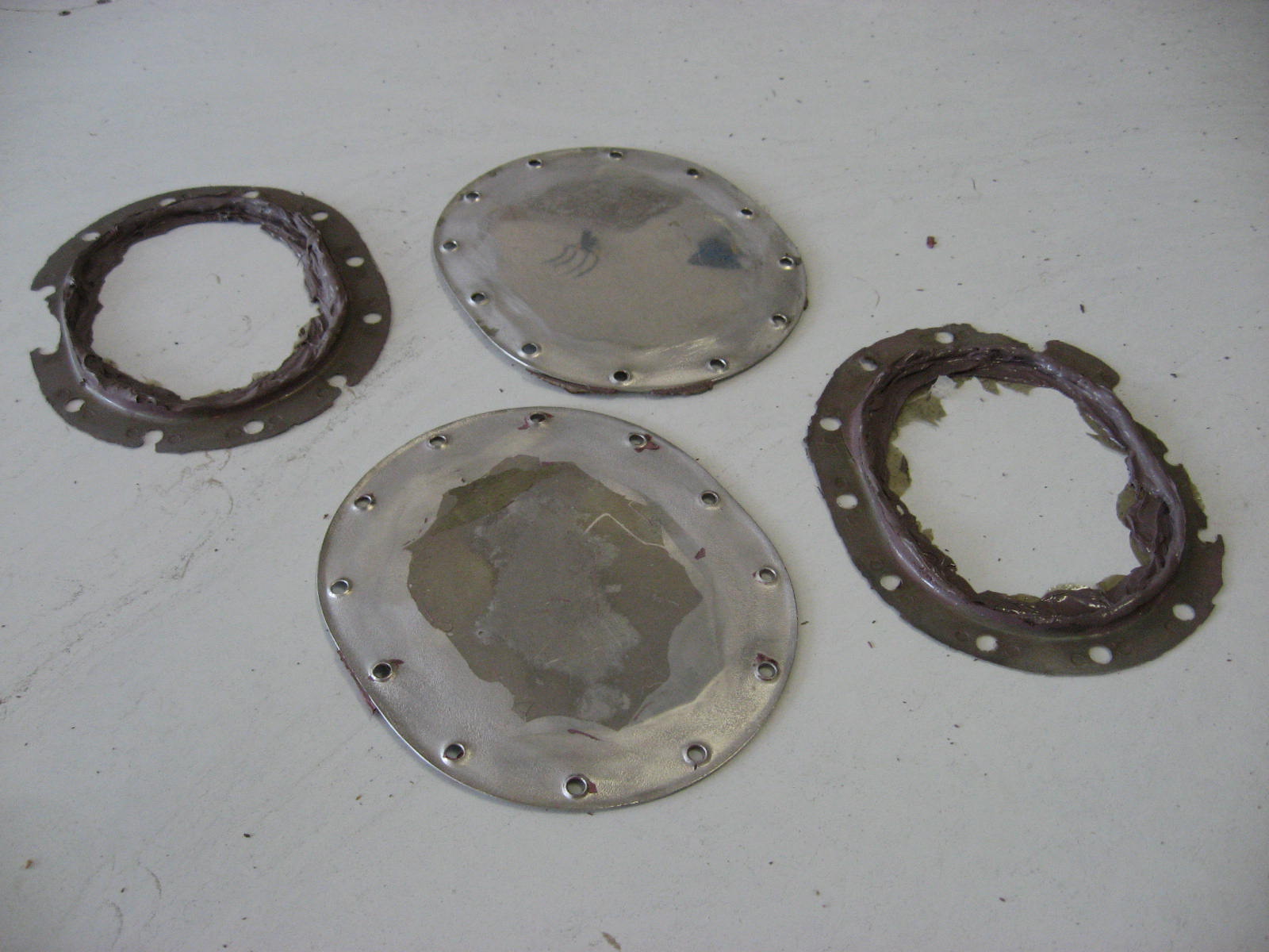

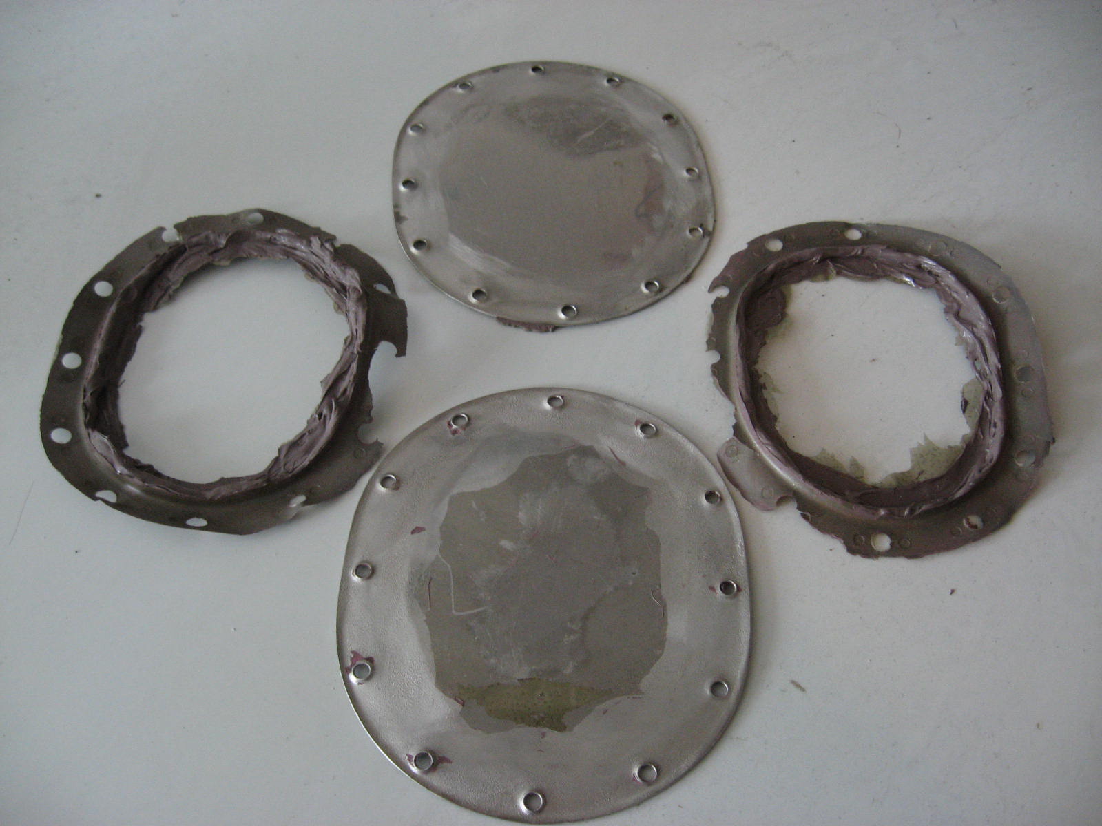

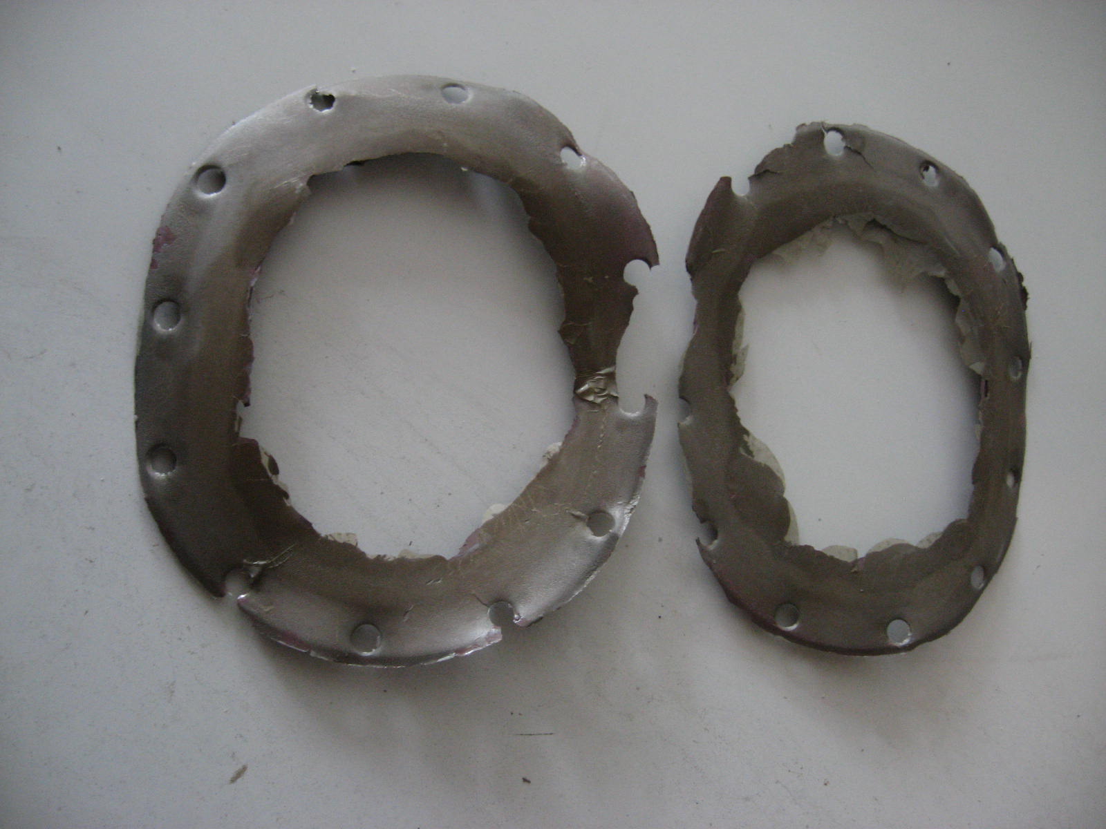

PostPosted: Fri Jul 20, 2012 5:29 pm    Post subject: leaking access cover Reply with quote
Gary:
Guess what I did this past week?
Here are some pictures of a hatch seal.  Obviously not by that sticky finger hatch attack.
Barry

PostPosted: Fri Jul 20, 2012 8:17 pm    Post subject: leaking access cover Reply with quote
I like when the sealant comes off like that. Was it leaking? Looks like it was sealed well.

PostPosted: Sat Jul 21, 2012 3:56 am    Post subject: leaking access cover Reply with quote
Hi Gary:
No - NOT leaking - - - At least not at the hatches.  Leaking at the inboard rib.
Barry
