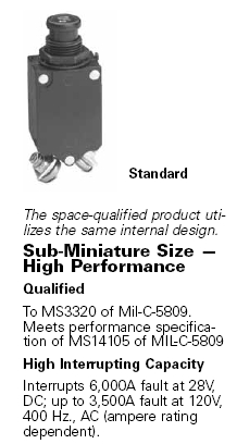

From the Eaton catalog:
[img]cid:.0[/img]
When the Crowbar OVM products from AEC or B&C or PlanePower
are installed per recommendations for breaker selection,
design goals are being met.
This style of breaker is exceedingly unlikely to ever have
been "tested" beyond their design requirements for qualification.
I watched some testing at Beech at the 3000A fault levels.
It's not a trivial task to generate that kind of test
level . . . it's not going to be 'exceeded' by the occasional,
mis-informed user of such devices. Further, using the crow-bar
shut-down technique downstream of such breakers isn't even
going to make the breathe hard much less break a sweat. I proved
this in the Beech test labs when crowbar shutdown was provisionally
qualified to be installed on the model 38P
http://tinyurl.com/7smb4k5
and later when the B&C standby alternator was added to the type
certificate for the A36.
My brother-in-law was similarly mis-educated by some grey-beard
journeymen when he got his ticket to string wires in buildings.
The tale being circulated was that any new breaker subject to
an hard fault trip was already 'damaged goods' and required
replacement.
This is counter-intuitive to both the reasons that breakers
exist, the skill of those who design them and specify them into
finished goods. This is old science who's utility should not be
polluted by those who have never been there, done that, or read
and understood the design and test data. If any breaker is at
risk for damage the first time it is tripped, then it's NOT suited
to the task and should be replaced with one that is.
Please refrain from personalizing this as "a disagreement"
between myself and others . . . please refer to the documents
cited and explain how they are not applicable to the discussion
at hand. Let us take care that we do not propagate shop and hangar
myths here on the List. Let us be specific on just WHAT KIND
of breaker is being discussed, what it's specifications are and
how it is expected to perform.

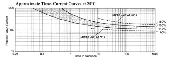

PostPosted: Wed Jul 18, 2012 6:47 pm    Post subject: Over-voltage Circuit Breaker Trips Reply with quote
At 02:04 PM 7/18/2012, you wrote:
--> AeroElectric-List message posted by: dlj04 <dlj04(at)josephson.com>
If it's true that a circuit breaker is damaged and can't be used once it's been tripped with a dead short, why would you ever use a circuit breaker? You might as well have a fuse.
As Bob mentioned, it is possible to create a fault current in excess of a circuit breaker's rated interrupting capacity, but you're not going to do it with a light lead-acid (or gel, or AGM, or LiPo) battery in a small airplane with any kind of terminals and wire between the battery and the breaker. You *might* exceed 5000 amps with a fresh NiCd battery from a turbine aircraft *if* the CB and OVP were connected to a bus bar or right at the battery terminals, but that would be about what it would take.
Exactly. There was a great kerfuffle in a Walmart
bag here on the List over this kind of data:
[img]cid:7.1.0.9.0.20120718213301.01e1a780(at)aeroelectric.com.0[/img]
This is an exemplar plot of breaker performance when subjected
to over-current impulses of up to 10x rated current. Certain
individuals chose to interpret these data not only as performance
scatter but as not-to-exceed limits as well.
The discussion was rooted in a projected crowbar trip current
of something like 700A which was in fact, greatly exaggerated.
There was also some consideration of single pulse current limits
on the SCR which is core to the crowbar ov module's operation.
When installed as depicted in AEC drawings, typical trip
currents were on the order of 150 amps . . . I did some tests
at B&C at 300 amps. Far less than the max interrupt rating of
the breaker and well within the capability of the SCRs.
A hard fault on an RG battery can easily exceed 1000A but
that's still less than what these miniature breakers are
qualified to stand off.
